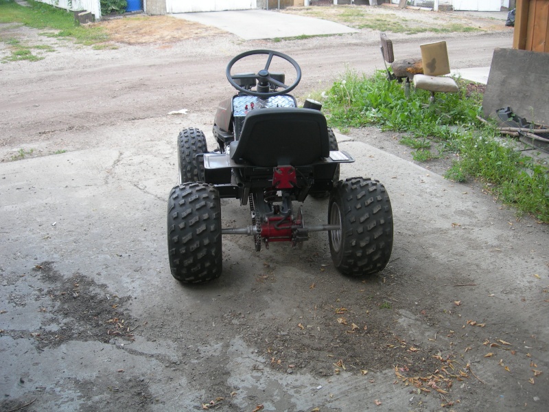

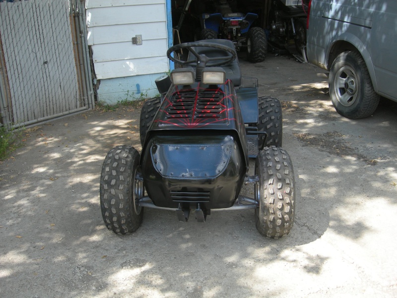

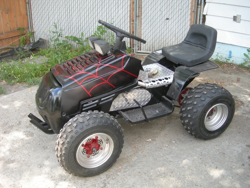

Suppose I should fill in some details.
Its a custom box steel frame, using 1989 Yamaha warrior front , rear , suspension and brakes. It has rear hydraulic disk, and capability for front hydraulic disk brakes. Drive line consists of new Princess Auto Honda clone 13 hp engine, Hilliard extreme duty centrifugal clutch, new NO. 50 chain new pillow blocks and keyed shaft for a jackshaft to the rear axle, All new sprockets , new take off rear tires., decent front tires, on stock yammy rims.
Geared for 55 mph, need to adjust for my lard arse.

I like it! Didn't the Warrior have 2 headlights just like your creation. My memory is a bit foggy about 80's ATV's.
Yes it did. Those are the stock units.
has a maltese cross tail light and blue leds under hood.
