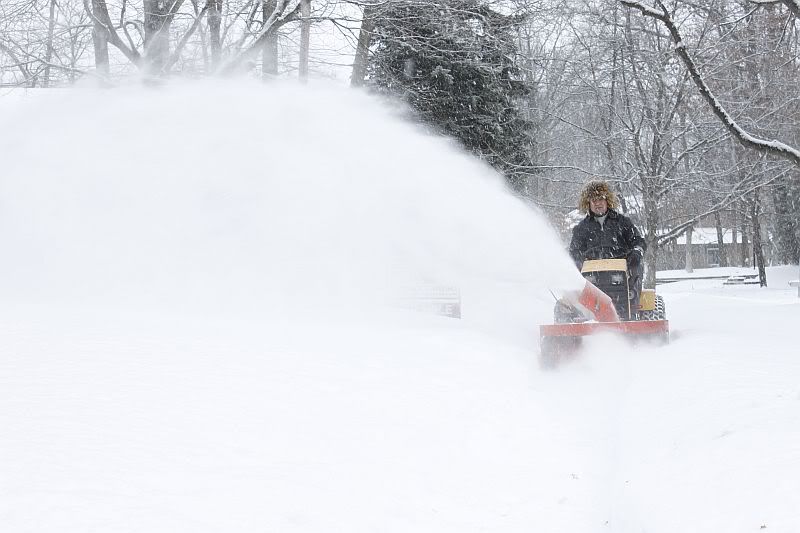

and this is ME on my 224 Torq last winter, ya it is a smaller wheel, but this thing handled all the snow I could throw at it last winter...it was a 'blast' to drive...

First with all single stage blowers 'rpm's' are key so if your engine is powerful enough to maintain good blower RPM's then you are in business. That said the proper mechanics of the blower must also be realized. Meaning you should have the right belts, pulleys springs and the belts need to be adjusted properly along with the clutch. Anytime you lose mechanical advantage due to some 'other' issue you decrease the efficacy of the blower. So, there is one way when it comes to the single stage blower, that is the factory way - the right way, any jury rigging, or wrong belts, pulleys, springs etc will only serve to cut into the ability of the tractor to blow snow. I used the small wheel Torq last winter and was quite astonished at how well it did. Yes it does have a low range which permitted me to move forward 'slowly' while maintaining engine RPM to 'launch' the snow. The Case/ Ingersolls also have the 'low range' which works out perfectly for snow. Anyone that would leave it in high gear and attempt to just 'drive through' the snow would be trying to launch snow with a spoon. My drive is on a 'slope' and it worked amazingly, I did have to 'add weight' since the blowers are so heavy it gave a forward bias to tractor and lightened up the 'rear end' making 'spinning' of the rear wheels a distinct reality. So, I made a weight bracket and added #235 to the rear end of the tractor, and no more traction issues...

The Torq is a model of Case tractor that was manufactured in 1974. There are only a handful of these models known to exist in fact I believe the total count is 4. What all the differences are is quite unknown since there were so few made and they are pretty spread out through the country we may never know the exact differences. There are 3 -224 Torq's and 1 -646 Torq. The are pretty close to the 'regular' production 224 and 646 but have distinct nomenclature naming them 'Torq's'. It is a fine working tractor for 100% sure. See the photo of me blowing snow last winter. In fact those photos spurned other Case collectors to get me blowing snow with something else besides the 'Torq'...
