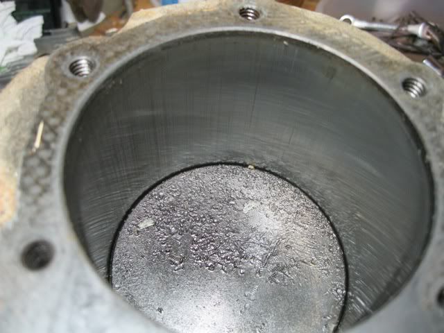

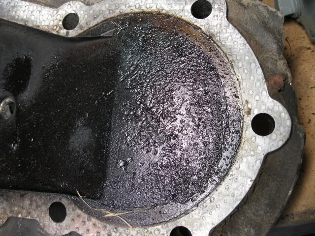

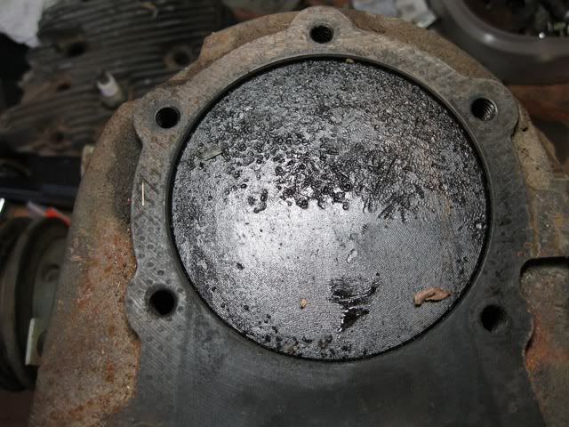

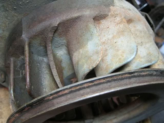

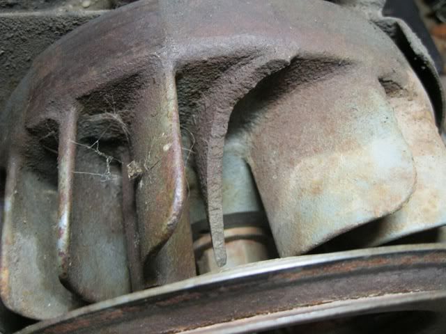

Well I found where the screws from the missing throttle plate went. I removed the head and found marks in the top of the piston. It also appears it was using oil, so I will be rebuilding the motor as well. Also one of the fins on the flywheel has about half of it missing.

Here is the piston.
Bore looks good I don't feel any ridge
Bottom of head is bad, but the head is junk anyway.
Missing fin on flywheel, I don't see this as a problem.

I think the missing fin on the flywheel is going to put it out of balance, it turns up to 3600 rpm.

If you're not going to work it hard or run it long, I have had to "Balance" one in the past (we were in a bind & it had to be done) by removing the opposite fin as best you can to the same.
We had a Tech 8 hp that ran for years & years like that on a tiller. As far as I know, it's still running... someone stole it.

That may be why the screws came out of the carb, to much vibration. I may see if my motor builder can balance it.
I have been pricing parts and I think I'll just ring it and grind the valves. 2 valves, piston, pin, rings, and rod will cost over $300, and still need a head, gaskets, tin for the top of the head, and a carb.
