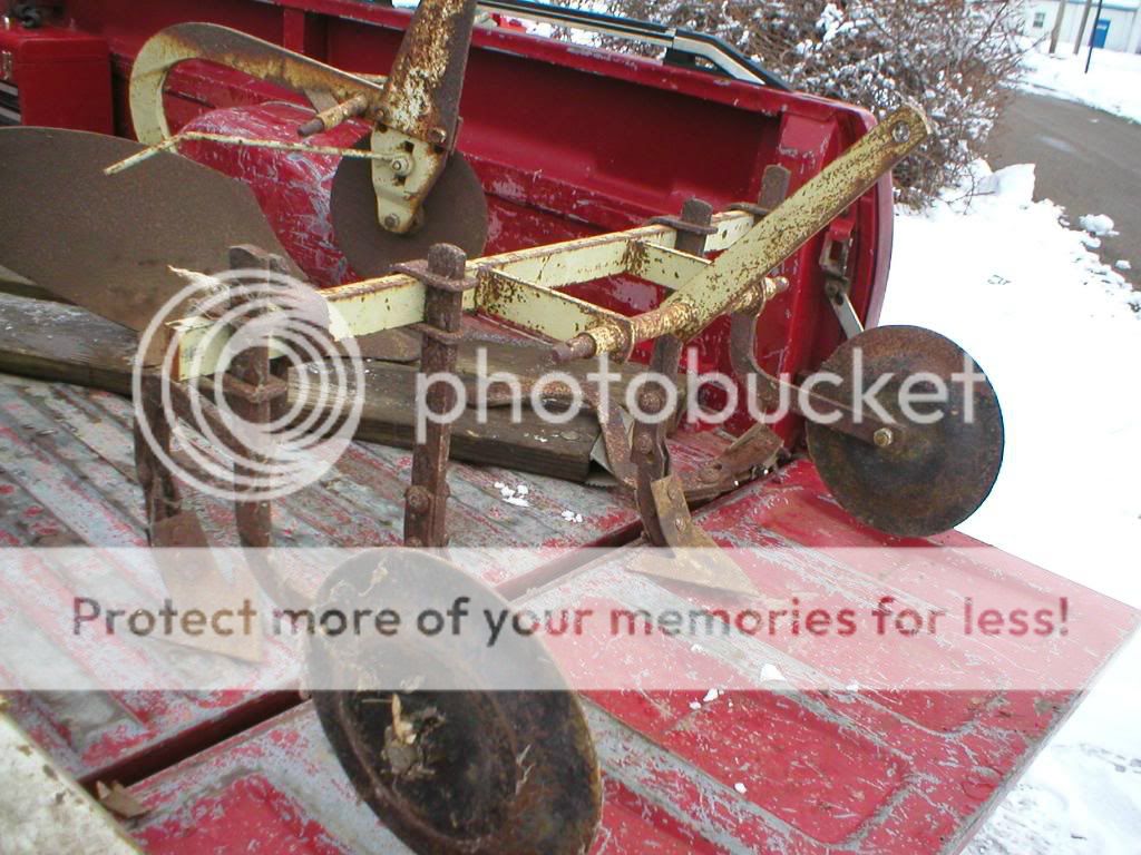

A cultivator would be easier to use I think. Most are basically like a tool bar to start with. You could use 1, 2, 3 or however many rippers you wanted, and still use it as a cultivator. Here's a pic of a sears cultivator, not mine but gives you an idea.
