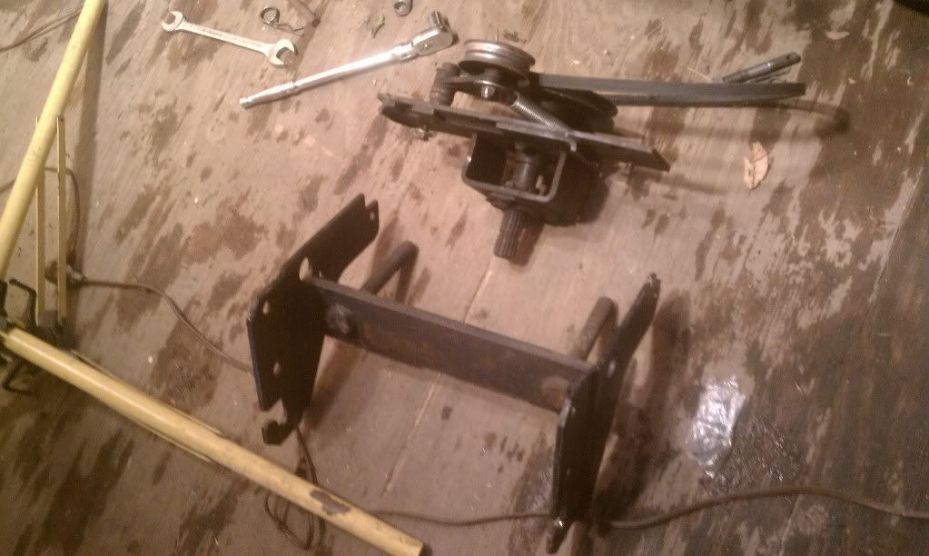

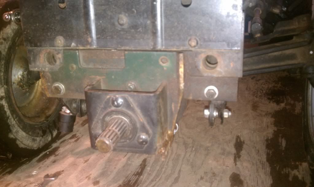

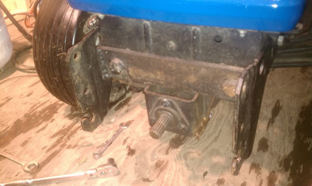

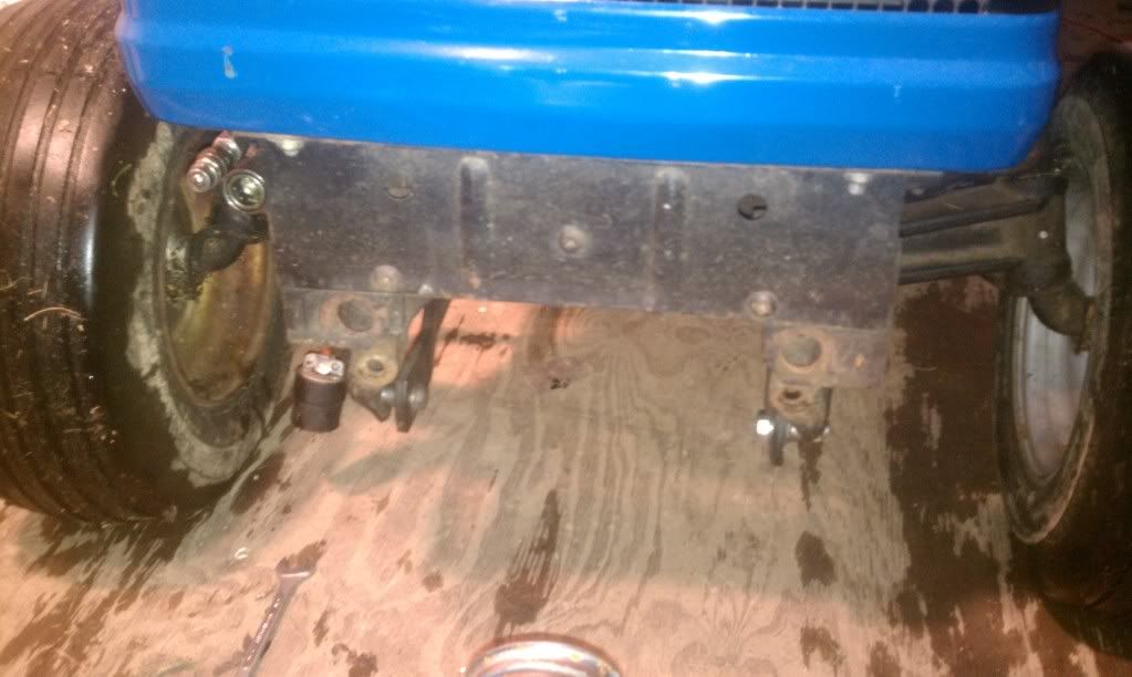

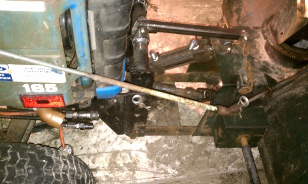

A few shots of my front pto for my diesel LGT165

Nice set-up ! Did you adapt those parts from another Ford ? Al
The pto is adapted from a Bolens XL12 as is the snowthrower.
It works pretty decent and has worked well for 2 winters, but this last storm really hurt the thrower , killed the driveshaft and the sprocket on the auger. I'm looking for a 2 stage unit I can adapt to my rig, anyone have anything, that's close to me ?

:ditto:The other comments. Cool looking Copper thingy right above the axle the right side of the tractor. It it the exhaust end or something else? :confuse:

That copper part was the exhaust exit, before I gave the tractor a paint job, now that part is a crome pipe.

That's a nice setup for the blower. Have you verified that you have it turning at the proper speed. If the speed is low then you won't get the throw distance that it was designed for. If the diesel isn't turning as fast as a gas engine would (3600) for instance.

Posted November 10, 2011 - 06:30 AM
