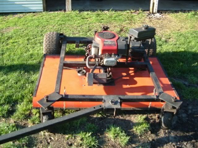

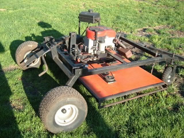

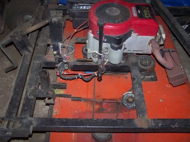

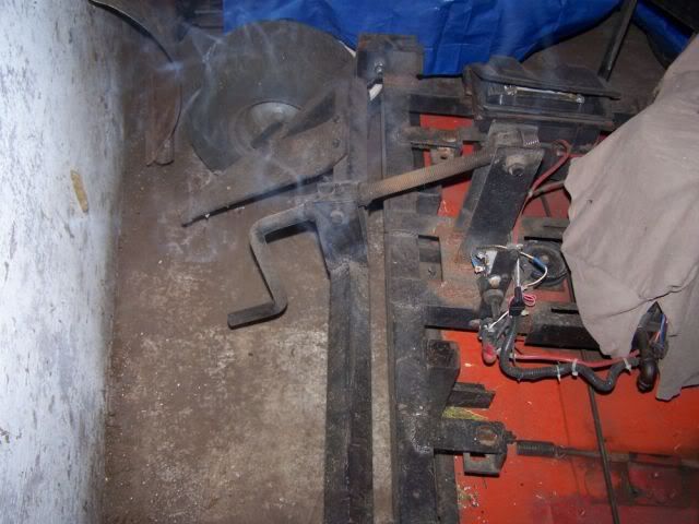

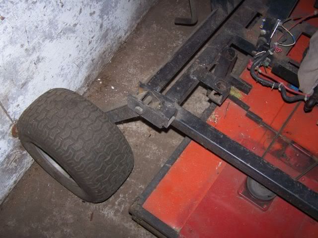

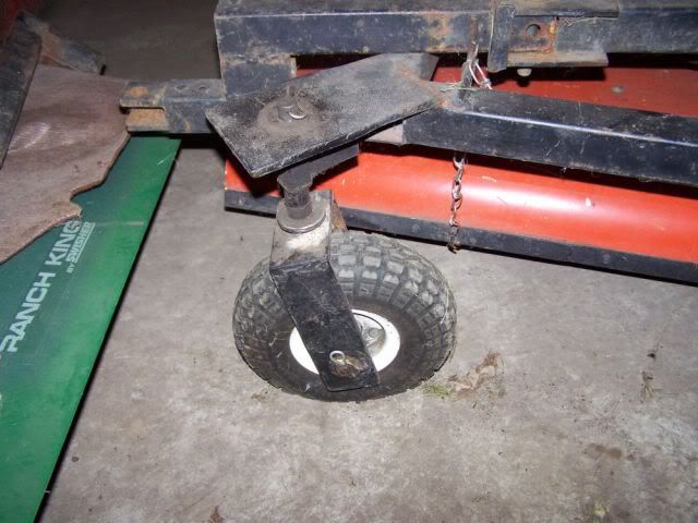

I built this 60" trail mower from stuff I had around my shop. It has a 15 hp. Briggs electric start. The deck was made from a small truck cap with the side doors. Just cut it to what I needed. Made a frame around it with 1" angle and added 3/16" plates where the spindles go through for support. Used rear tractor tires and a crank from a piece of farm equipment for the rear adjustment. The frame I built with 2" square tubing and the rest you can see in the pictures. It mows great and being open all the way around it doesn't leave wind rows and doesn't clog in the tall stuff either. I've used if for 5 or 6 years now.

Posted November 05, 2011 - 06:34 AM
I like your mower, 546cowboy. Nice job on it!
