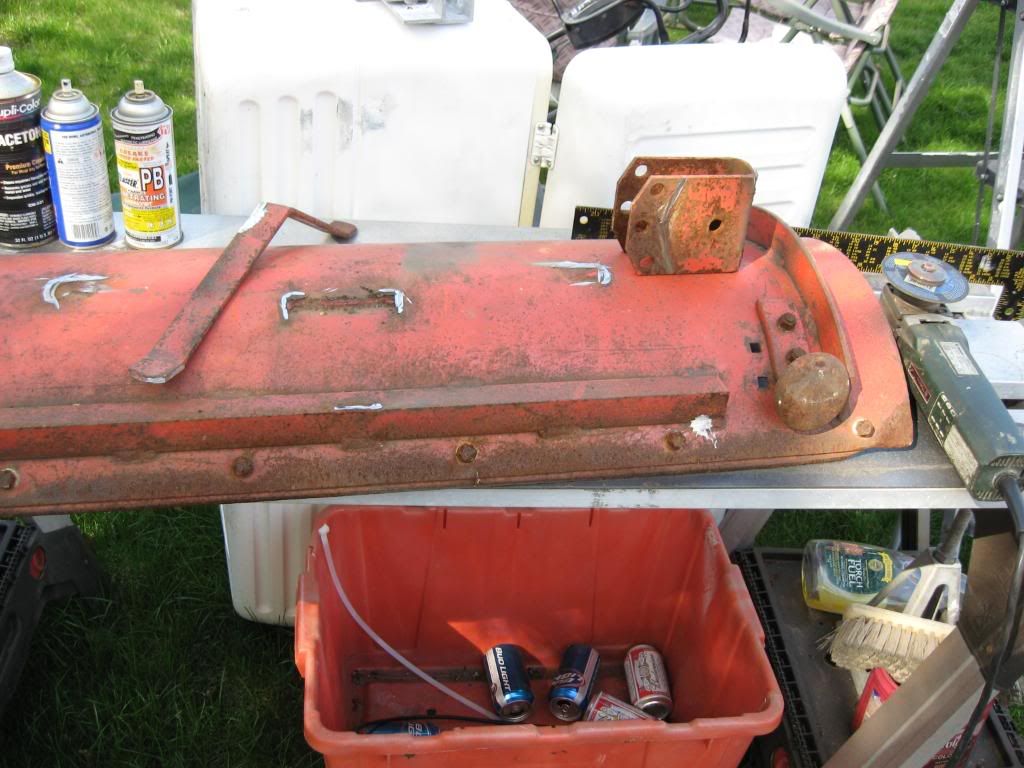

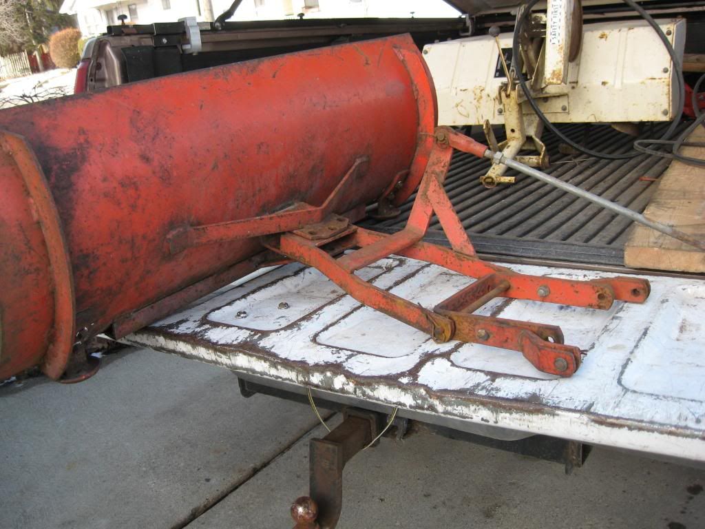

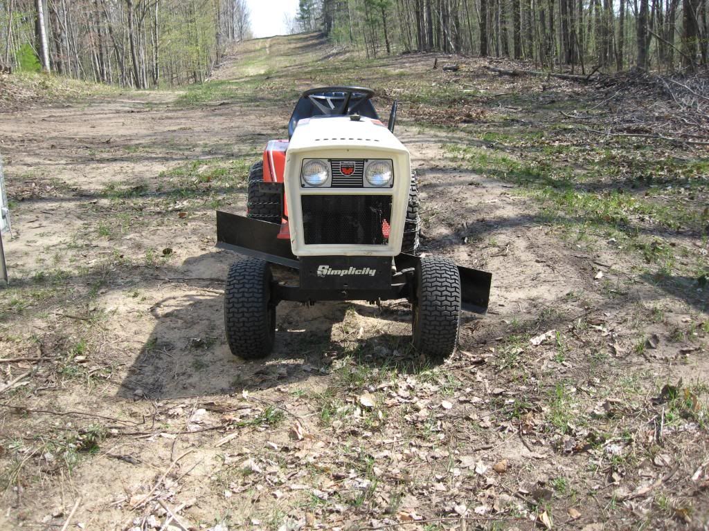

here are some pics of a grader blade i built for the Simplicity & Deutz as requested by texas deere. these are very hard to find blades, hence the reason i made 1.
but mine is 60" wide and a bit lighter than an OEM grader blade.

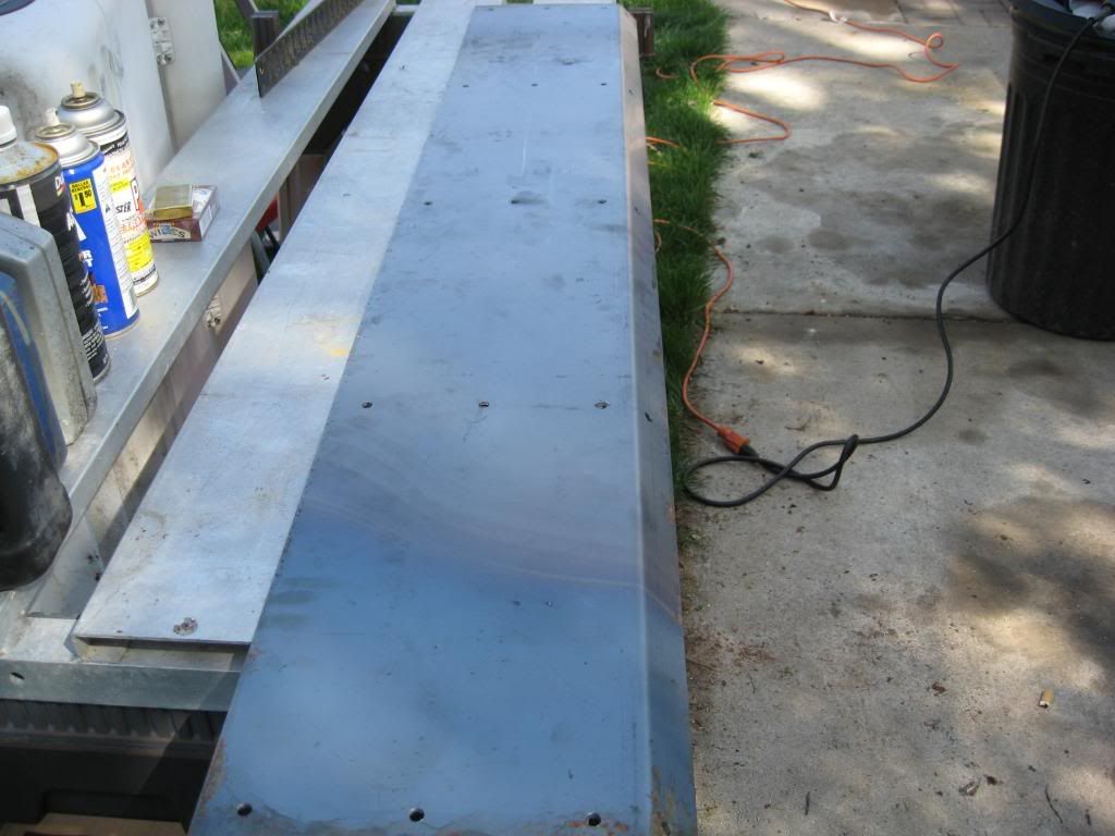

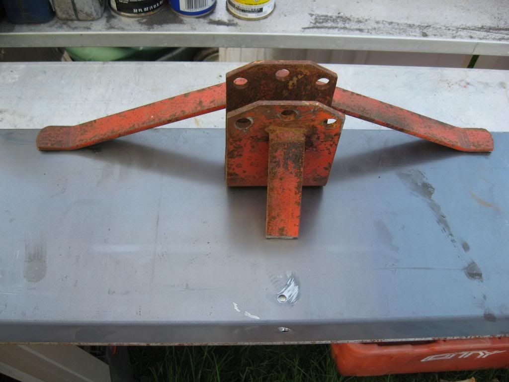

holes to weld 2 of these plates together
donor blade
what i took from the plow blade

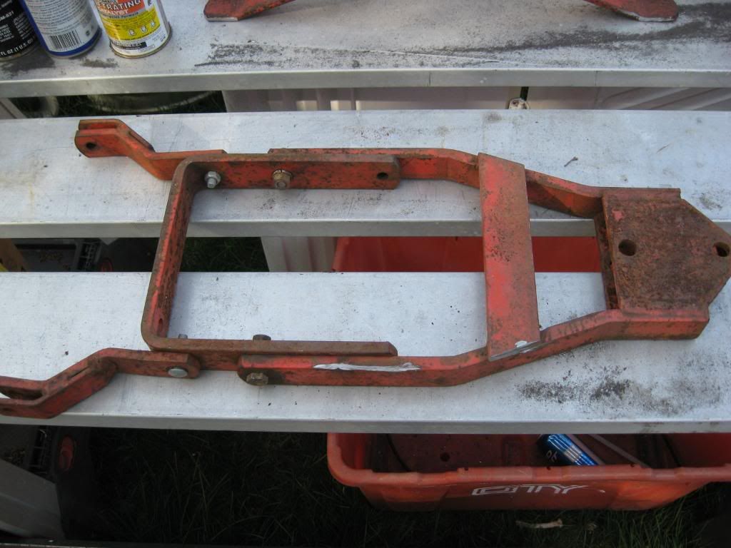

donor hitch

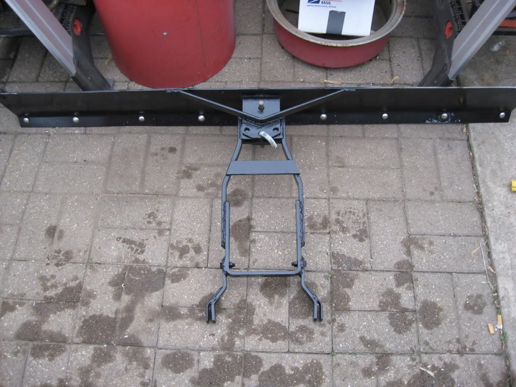

the back of the blade w/fresh paint

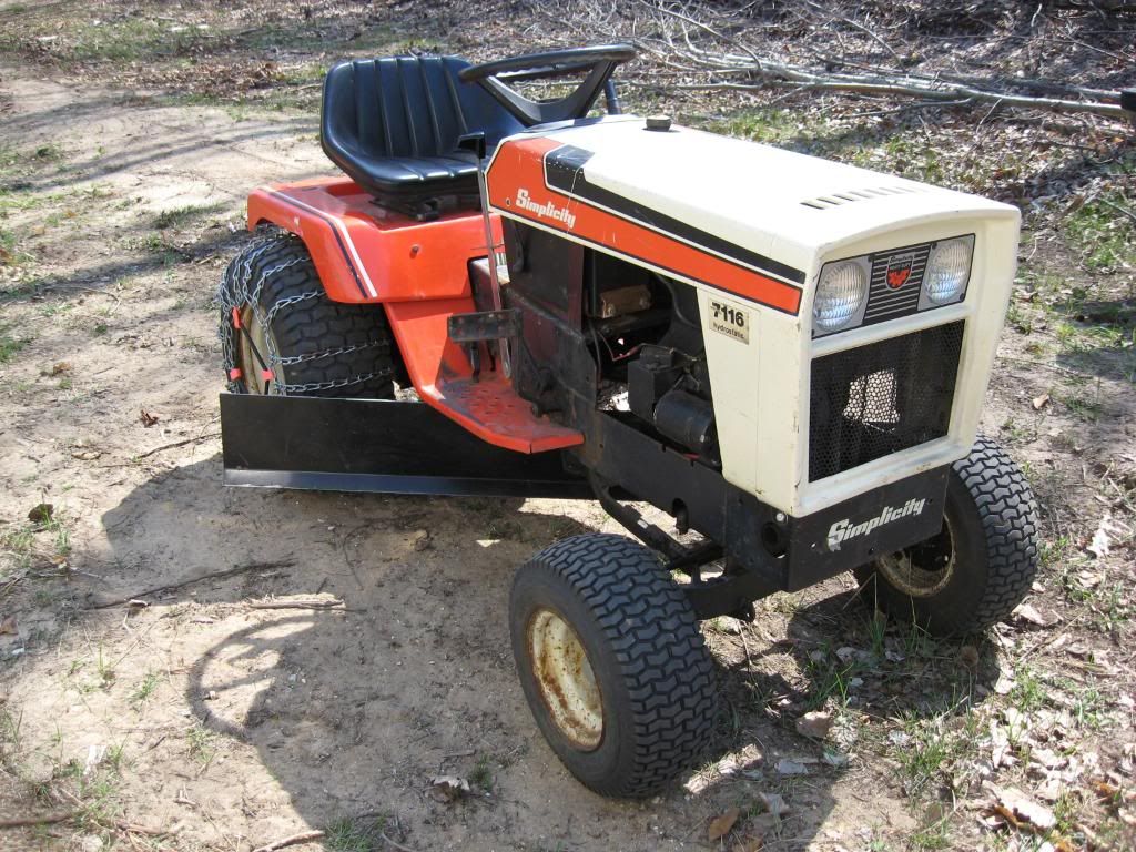

finished product
on the machine

Looks really good. I thought it looked wider than normal in the other post, but it looked well done and thought maybe they made 2 sizes.

Thanks for posting. Where did you get the hitch, was it from some other belly mount tool? I am going to have to get building one of those, just because it looks cool under the tractor.

the hitch is a plow blade hitch, just shortened up about 4 inches.

Looks like that should work great. Oh and nice looking tractor too!!
