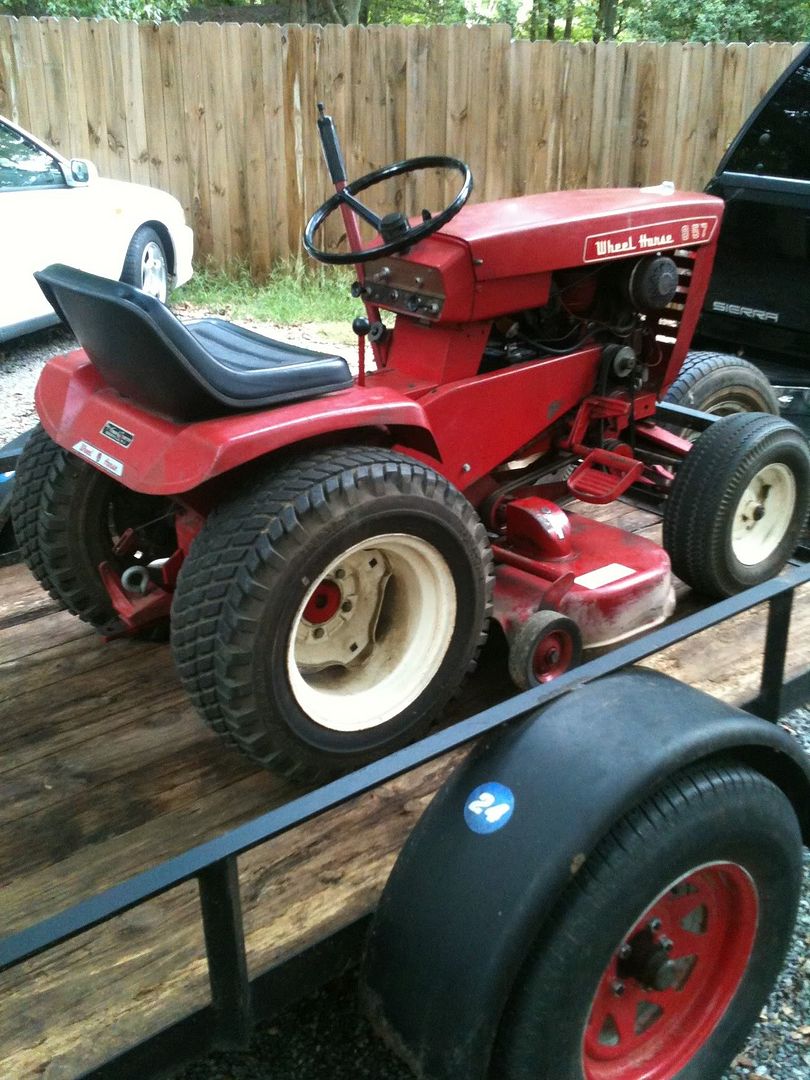

I started looking for a GT to do some light duty work. Thought a 300 series was what I wanted. And so the search began. Discovered that I kinda like the old round fender cubs. I couldn't find what I was looking for, then I spotted a 67 857 WH on CL.
I'm a sucker for old stuff in great original condition. I got this from the original owner family with all the paper work from purchase to all work done to it from day one.
It runs great, and seems to be un molested other than routine maintainence. Still has wh front tires.
A couple pics
Btw, anyone know what the bracket is next to the tension pulley in next to last pic? The
Belt falls off easily.

Looks good for being 44 years old.
The bracket looks like an attempt to keep the belt on when it is not engaged.
Would you mind posting the tractor's serial number? It is on a plate up tight to the bottom of the dash panel as seen in the 2nd and 4th pictures.

Very nice survivor. That was very well taken care of.
It almost looks like the outside pulley was moved in a little bit at some point, maybe not quite in alignment?

Welcome. Nice WH. Your belt may be a little long/stretched. Alignment can be a factor, also. Check it all out and enjoy it.

The "bracket" is there because the correct wire guide isn't.
The "L" shaped guide on the movable tensioner pulley (connected to the PTO pedal linkage) also needs turned 90 degrees clockwise so it will hold the belt in the pulley groove.
This should explain better:
Very nice 857, by the way! :thumbs:

Thanks all, I really like this ol GT. Cut some grass today, works great so far.
After looking at the manuals I found that the bracket is an attempt for the wire guide as wh1056 stated. I'll mess around and make it work.
