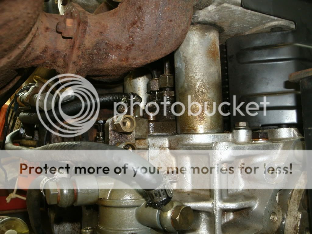

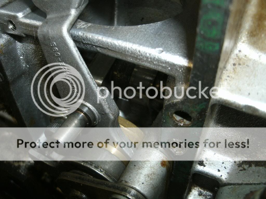

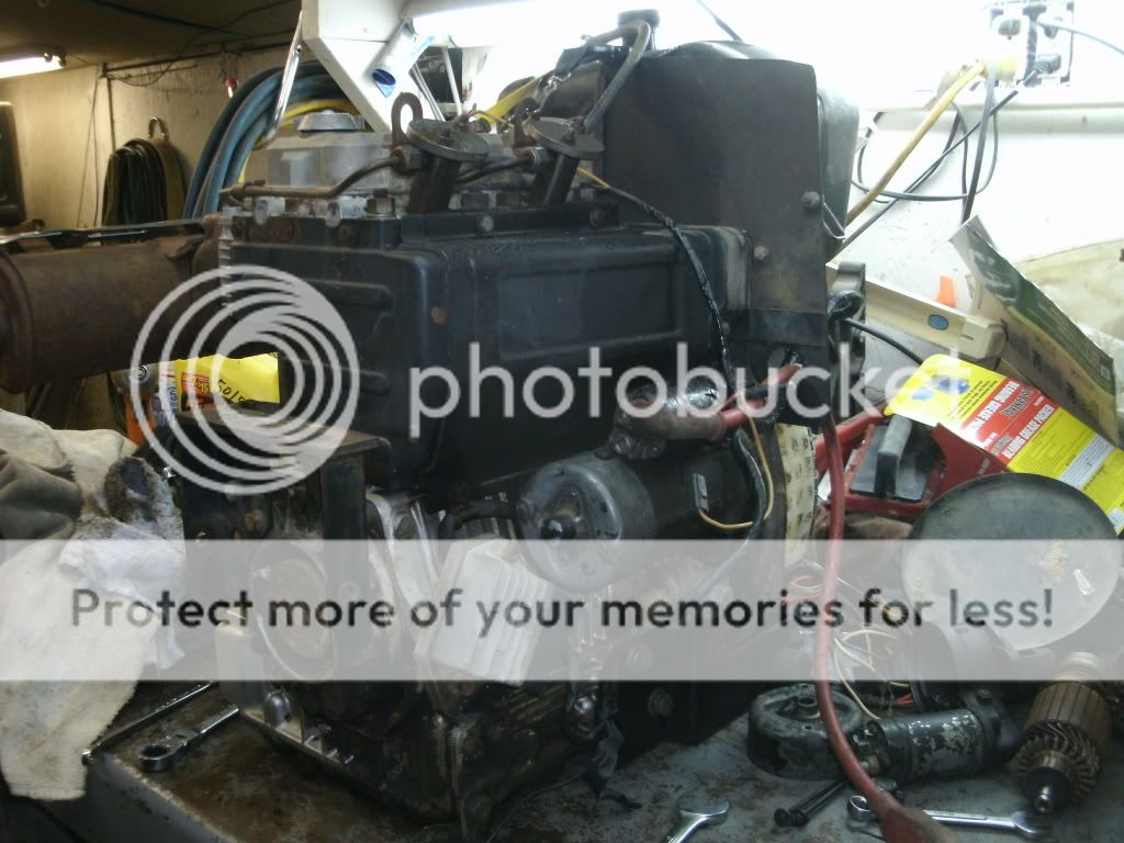

Well, Last night I tried screwin with the motor but the starter kept kickin out so I ripped it off and tore it apart and found that the solenoid was bad so I took the burnt up one I got when I bought Trucker tractor and tore it part too and used the best parts from each and put a decent one together. The original starters on these things is marginal at best. I can see why Trucker put the Gear reduction one on the other 920. I'll be gettin one for this in the near future.
Well The injection system doesn't want to bleed up to the injectors so tomorrow I'll probly pull the lift pump apart and see whats up in there and if that doesn't do anything out comes the Cambox pump. I'll probly get the Injectors popped and reset too( Its great having a buddy that owns a diesel shop)
Heres some pics
Also how many guys have this manual

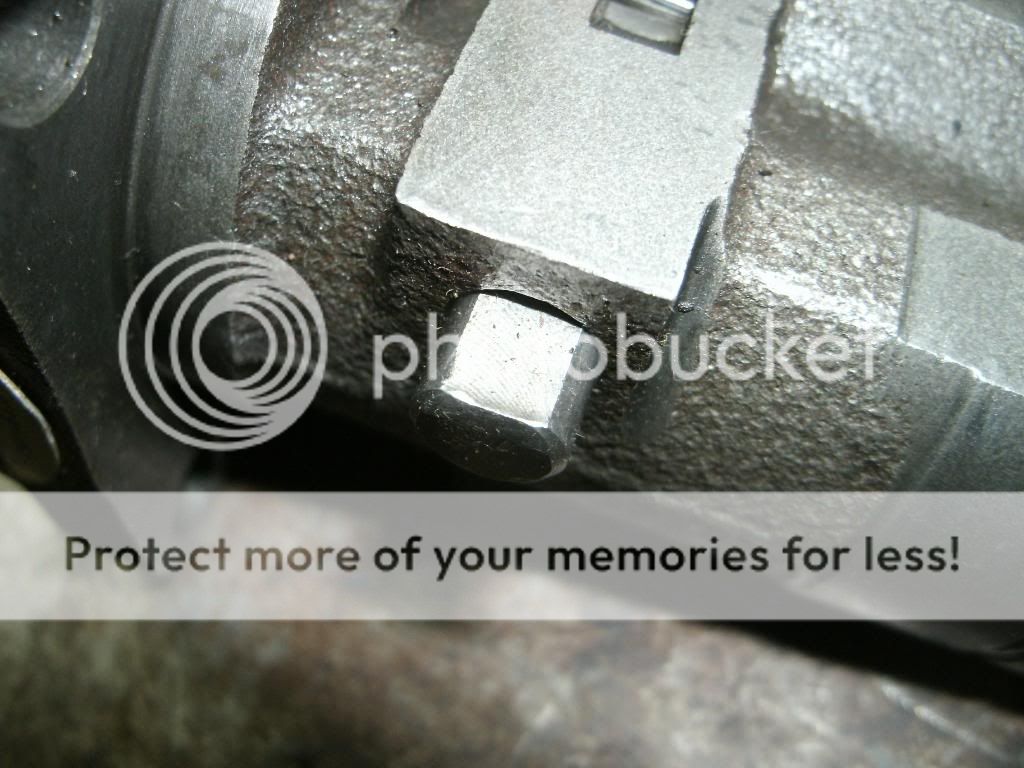

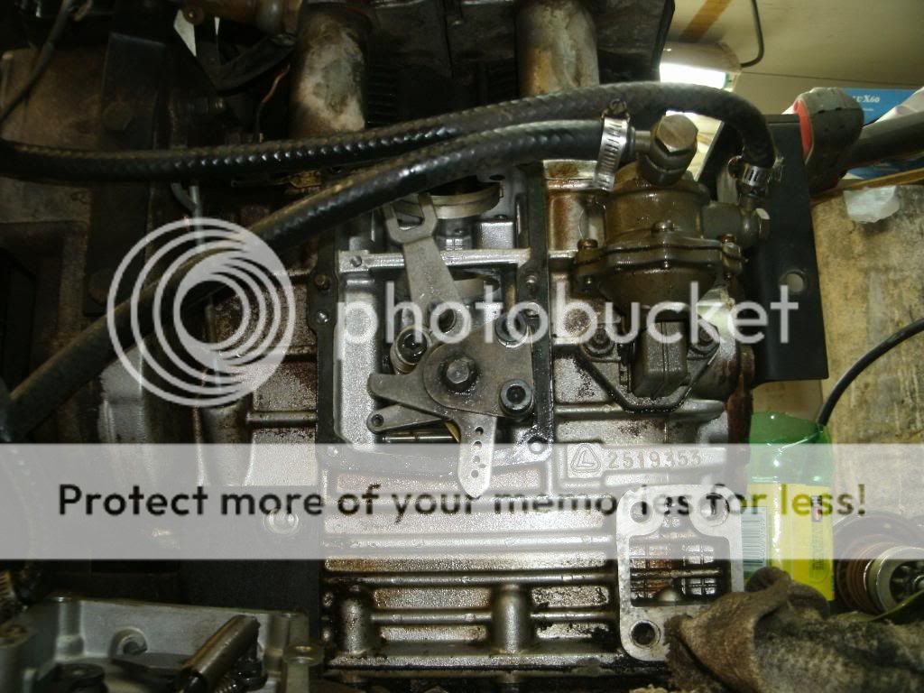

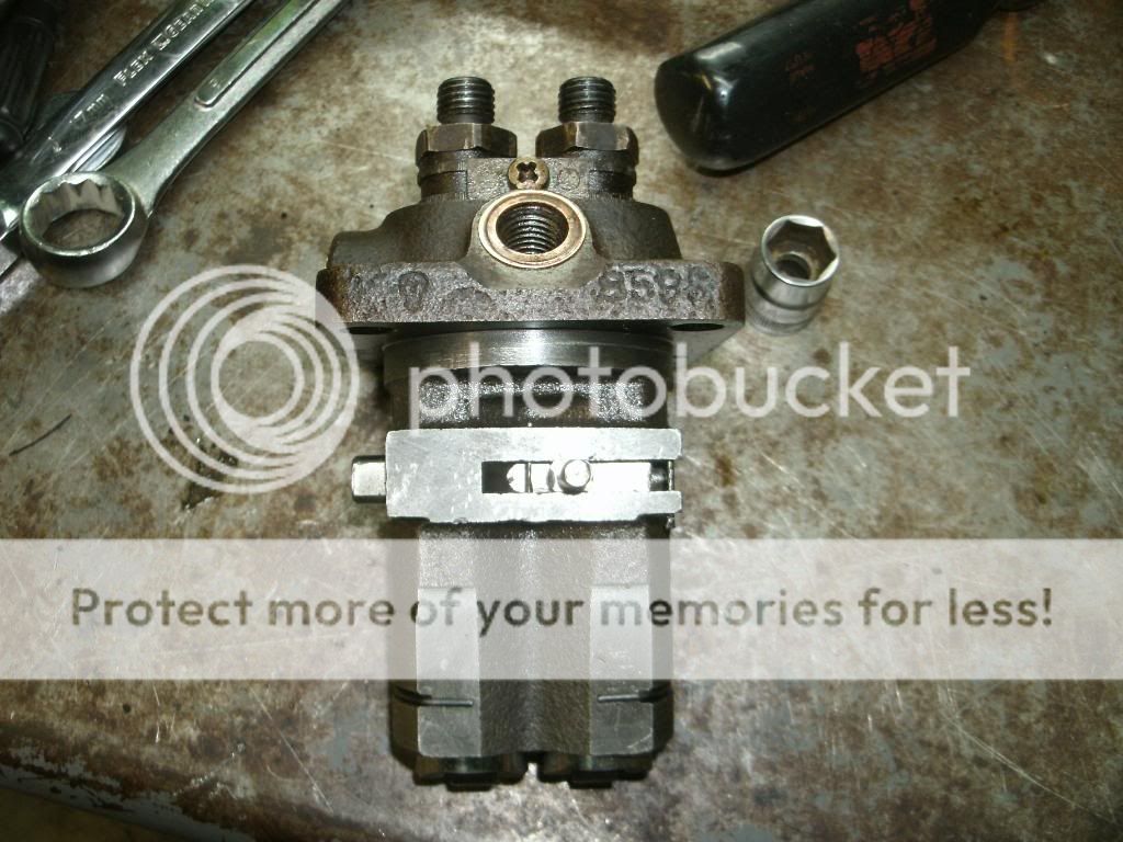

So I dug into the injection system today and found that someone has already been in there screwing around. Anyway i pulled the injection pump (aka Cam Box pump) and found that the rack was stuck. I also found signs that the tractor sat for a while and thats why the pump stuck. A PO somewhere along the way has had the pump out and tried to free it up in a very crude way. There are marks all over the pump from someone beating on the rack with a hammer. Hopefully I can find a new pump for a decent price but I'm thinkin its probly gona be about 500$ to get one. A buddy just got a new one for a Ruggerini single and it was 320 at his door and had to come from Germany.
Pics

There's gotta be a way of getting that one apart surely! If gotten apart, one could machine everything back to spec where it is swelled & nicked. I'd sure have to try if it were mine!

Yeah These pumps are rebuildable but parts are expensive and a lot of times you have just as much into a rebuild as you would if you just bought new. I'm still waiting for a reply from a guy who has a blown up motor he's parting.
I do have an Ace up my sleeve though, a buddy of mine is a certified Bosch tech and knows pumps inside and out of all types.
The few knicks and what not on the outside aren't what bothers me, these cambox pumps are known for the plungers sticking after sitting a while and if you know what your doing they can be freed up relativly easily if you let em soak for a while in PB, wd or whatever your favorite panther piss is. Its when you don't soak em and just go nuts with the hammer and punch when they break spring retainers and score the plunger and barrels. Thats what had happened to my buddys Ruggerini pump.

Well I took the pump over to my buddys and we tore it down. Its gonna need plungers, barrels, a couple washers, rollers, and a rack if its cheap enough, this rack could be used but it will have to be lapped back into the bore.
