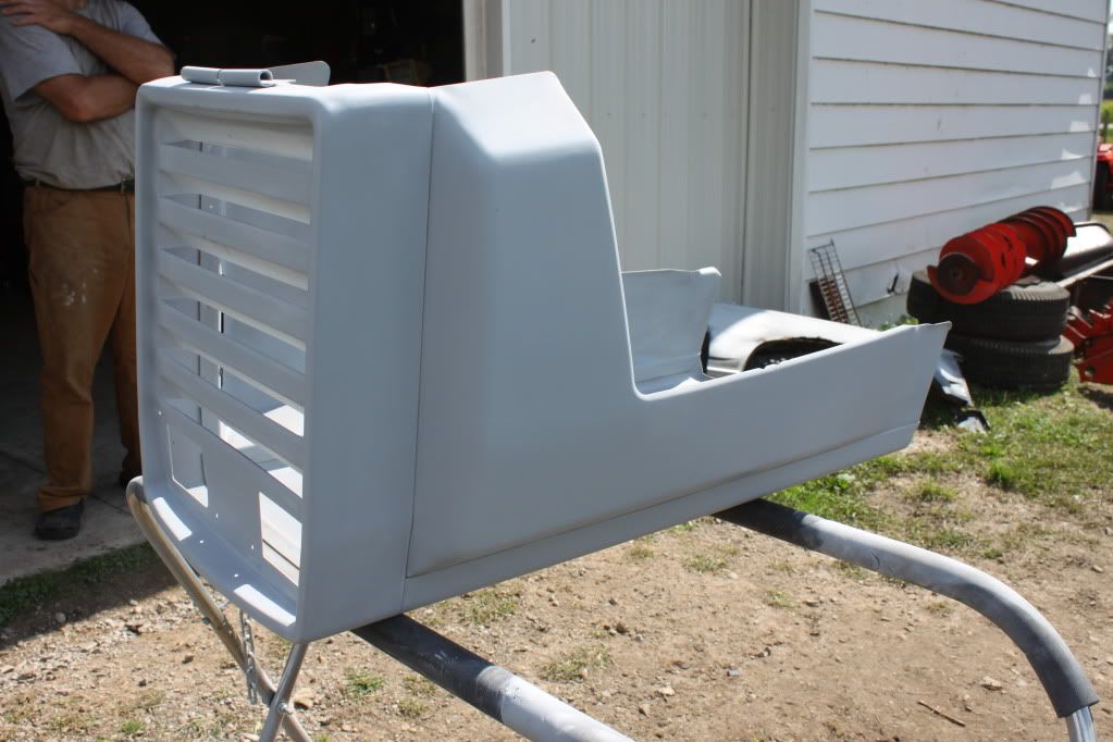

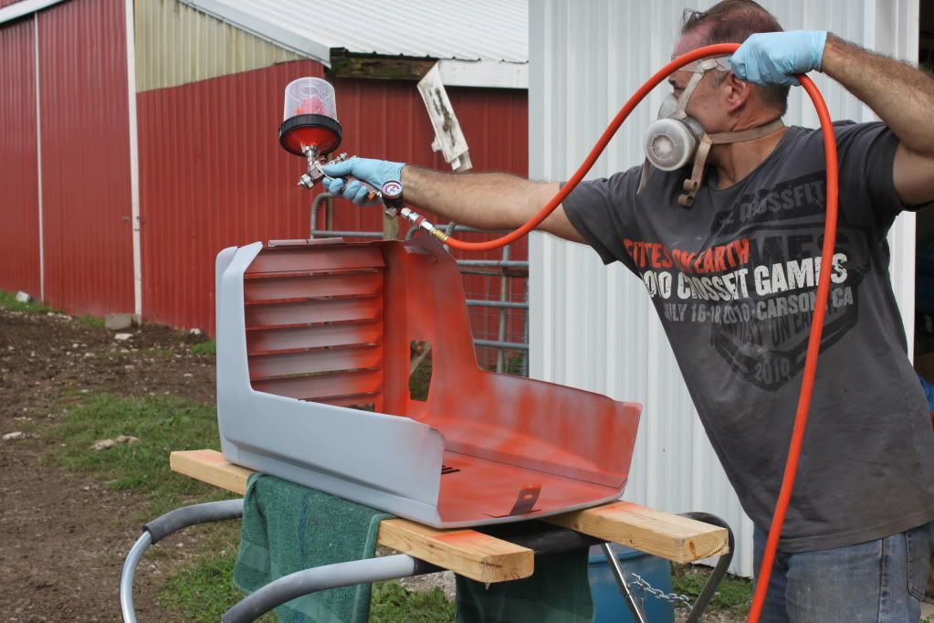

Looks good! Looks like you spent some of it watching paint dry. Thanks for the pics.

That looks great Jim.

Nice hood, paints looking good too.

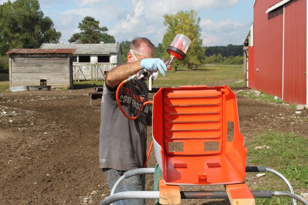

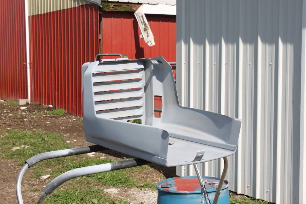

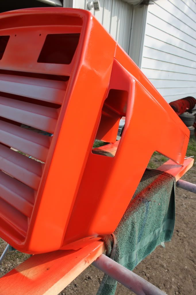

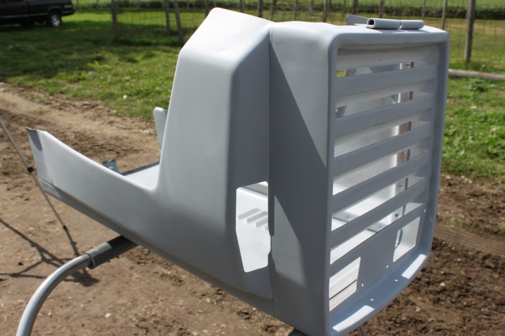

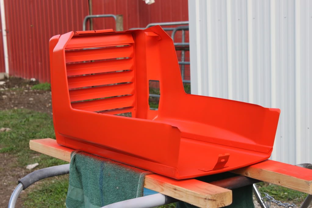

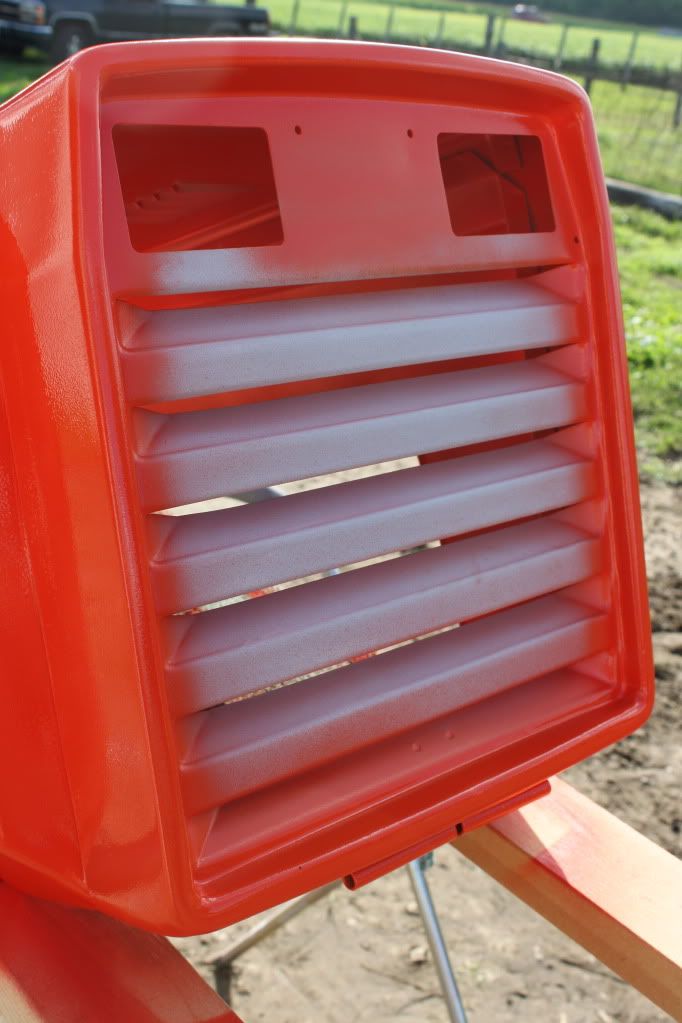

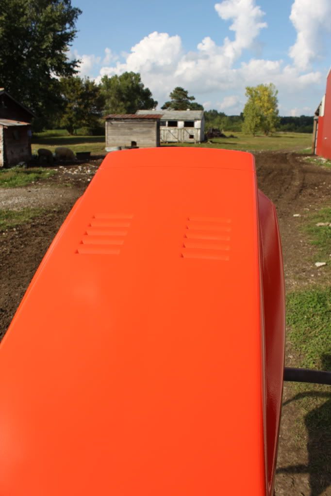

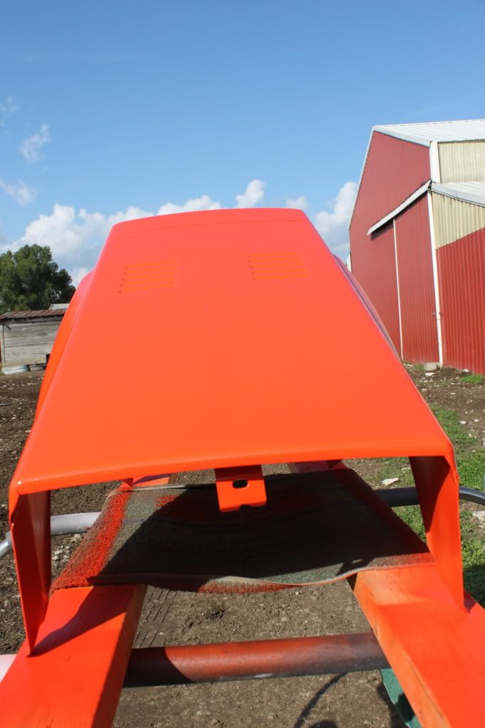

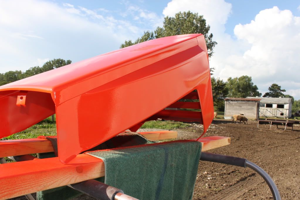

And thanks to everyone that commented...was a lot of work getting to the point that it was acceptable to spray...yesterday was a perfect day for it. I did all the work at my buddies shop and he has the best - show grade automotive equipment (Chip Foose SATA detail gun), we used evercoat show products to get it flat and ready for color.
Next up for the hood- Color Sand and Buff (Meguires products for that) It will shine twice as much...then decals

Looks like quality work.
Post pics after Buff

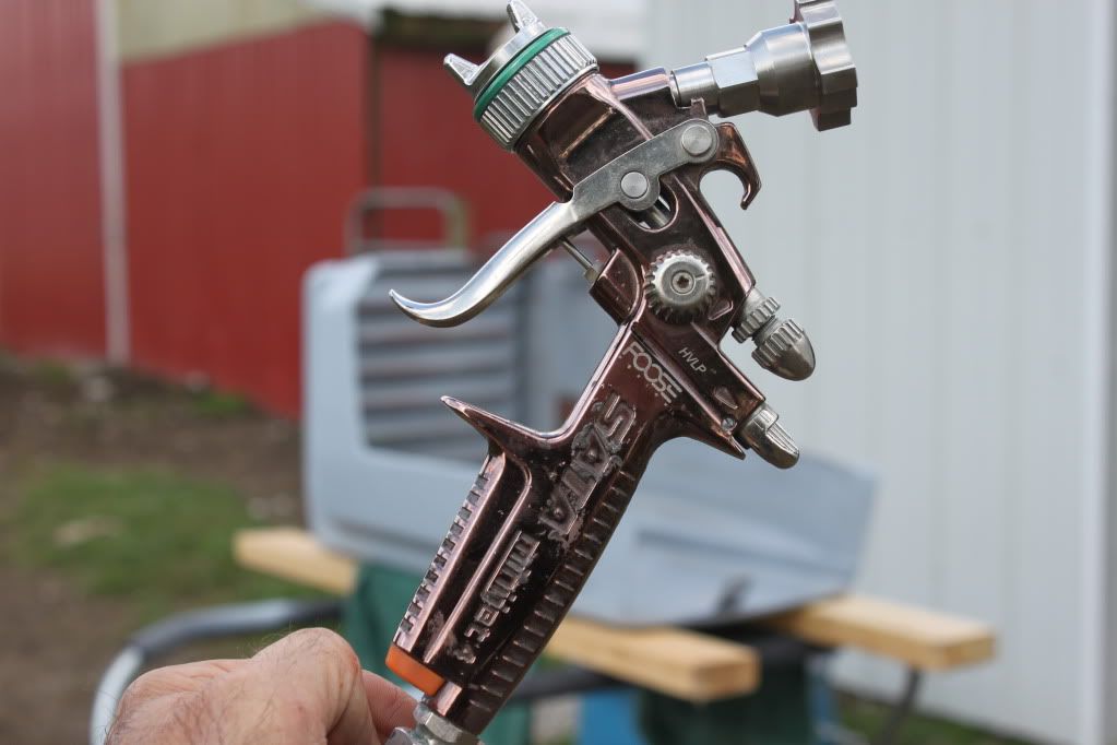

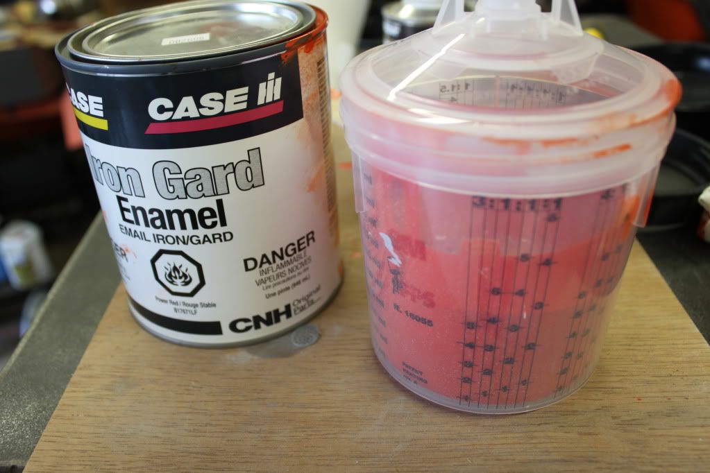

That Foose gun....the paint is in a bag? Looks that way & never seen that before. Way quicker cleanups! Good paint job too!
This was the first time I actually sprayed with this 'system' the gun has either the regular canister or the bag system. the bag was quick to clean up for sure. My buddy has a Sharpe Razor for the 2k primer and it was magnificent, you cannot spray the high build with the bags, just to dense...but the color was superb, and the clear was just as nice...
This hood is for my worker bee...eventually I am gonna have to do the fenders...

and the 3m system makes it easier IF you clean your guns lol

The hood looks good
If you Spray with any gun the quality of Jacks Digital SATA 2000, or the Foose SATA and you don't clean em 'real good' your a moron...LOL
The HF guns are 'throw aways'...NOT SATA's
I use a 3M paint gun,and it is just like that,with the "bag". You're right,clean up is easier.
