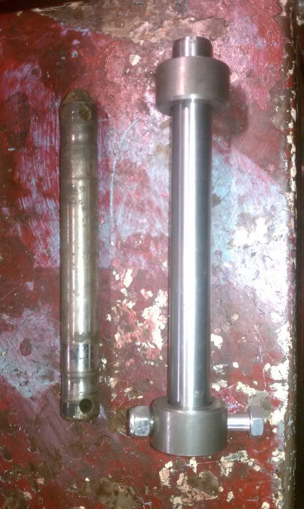

Posted September 07, 2011 - 05:02 AM
Kenny, a teaser shot of your present

Posted September 07, 2011 - 05:06 AM
Coooooooool!!!!!!!!!!!!! I had thought of putting a grease zerk in the axle bottom after I put it back together. Looks like I might get to do that. Thanks!!!!!!!!!!!!!!!!!!!!!!!!!!

Posted September 07, 2011 - 05:32 AM
Looking at the old pin, that is real similar to the one I took out. I kept it to use elsewhere, maybe a hitch pin for the trailer.
