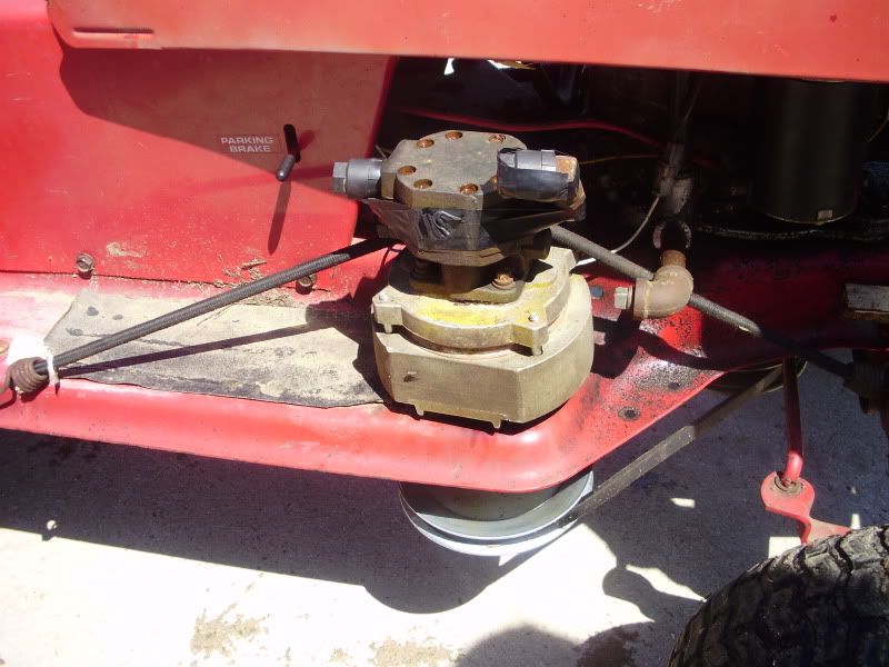

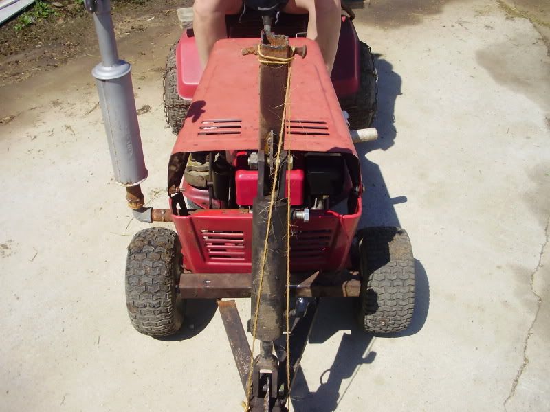

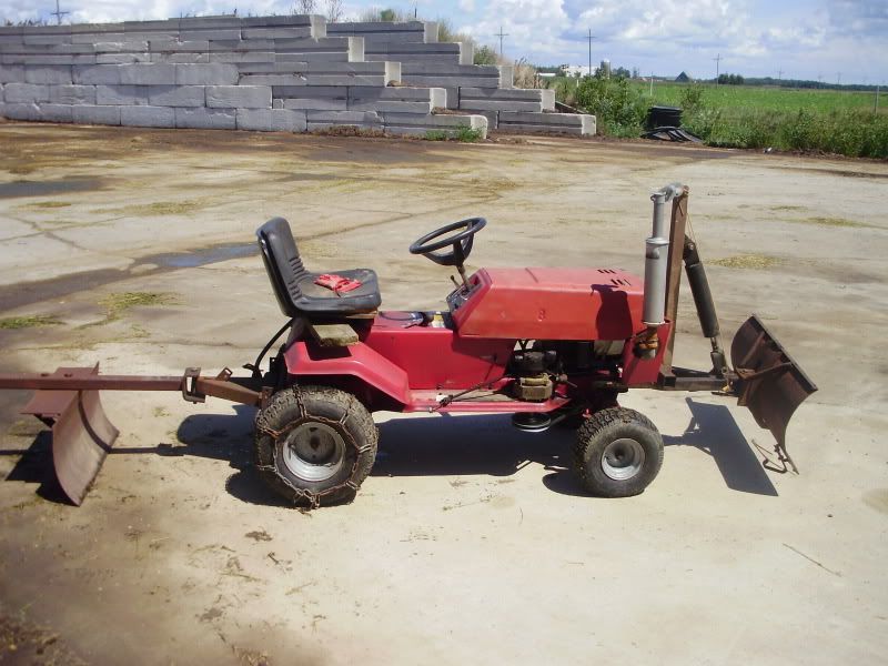

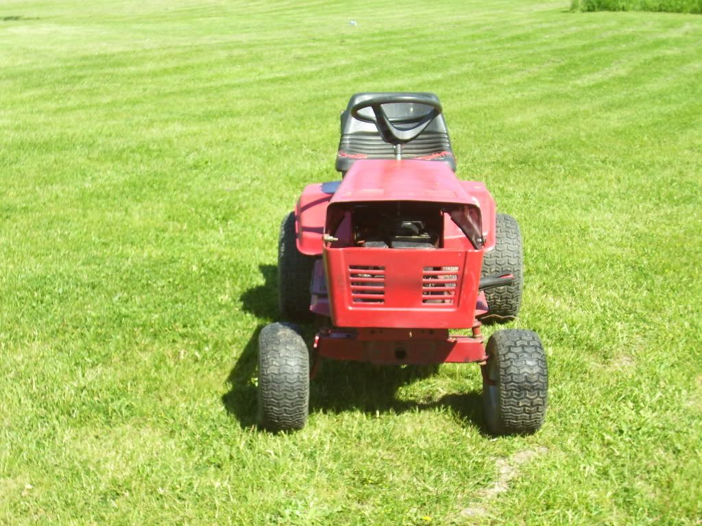

Just thought I'd post up some pics of my only tractor. An old murray thats been modified many times over, and my latest endeavor. The addition of hydraulics. Enjoy:
What I started with
Where I'm at now. Its a work in progress

Welcome! Cool Murray. What kind of pump is that?

Are you going to have a lift for the rear too ?

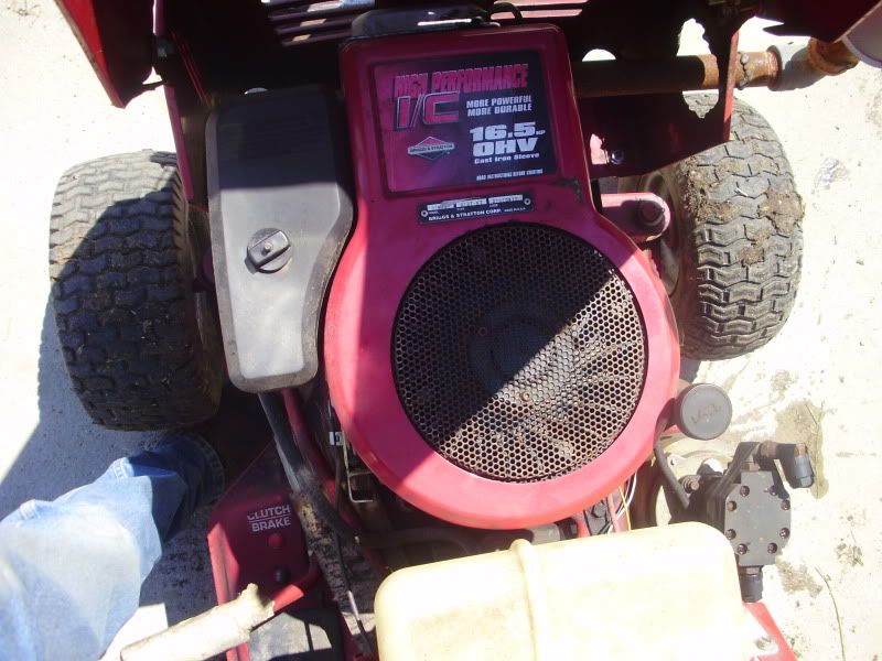

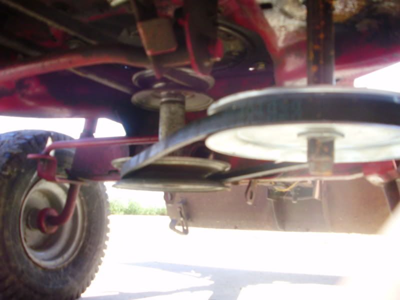

The tag on the pump says mfgd by John xxxx co. Cant remember the rest of the name lol
The pump originally had an electric motor powering it. When i got it the motor was a seized up peice of junk, so I removed the motor and retained the 2 aluminum ends from it since they had nice bearings in them. Then I picked up a belt and pulley from TSC. Worked out just right to drive off the unused pulley that was previously used to power the mower deck. The pumps original purpose was to serve as an emergency backup on an 89 F-350 bucket truck.
Sure am, got a matching cylinder for the back. Just have to round up some valves and finish installing the pump. I dont think that bungee would hold for very long lol.

Got the upright in and braced up:

I hope your cylinders are long enough. LOL

oh yeah! home meade at it's finest!:smile1:
be carefull of how much weight you put on the rear of that beast, the tranny in those are not exactly known to be the stoutest in the bunch. good for what they are but.... the bushings at the ends of the outputs will try to walk out on you if over taxed. then you'l need to replace it---with something stronger of course:D

lol ive pushed that rearend waaaay past its limits many times and she aint blown yet lol.
The cylinders were free and they matched so thats what im using lol. beats a manual lift.

Put two mounting points on the uprights and you can move to the lower mount and use the cylinders as jacks to change tires etc.
