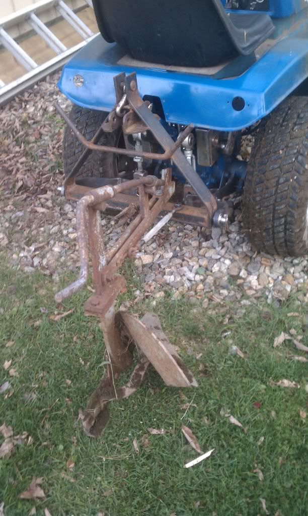

Well tried it it pulling logs ,one word can describe it ....... AWESOME!! That little Kohler can lug ! And the hitch works awesome too. I am very happy with the results for sure!

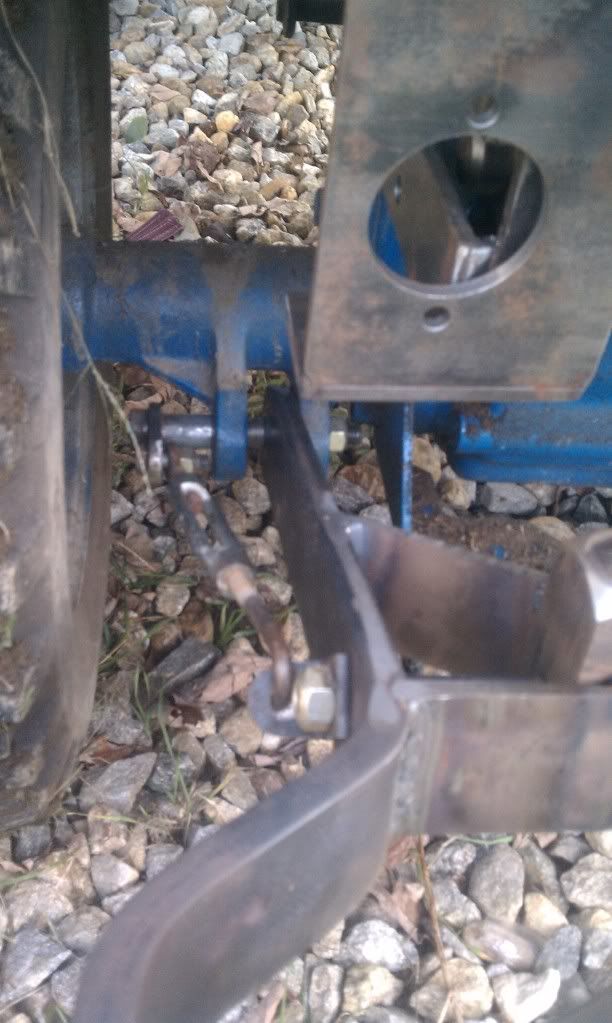

Still fiddling with the fine details as I want this thing as close to perfect as possible. Right now I'm messing with side stabilizer links . Also 2 different versions of Lower arms , ones with out ball swivels and with them , I used pressed in versions on mine and they are expensive! Stay tuned pics soon.

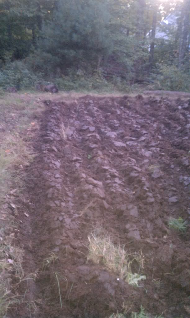

Impressive to say the least ! all the extra holes are totally usable and make sizable differences . the side stabilizers work out nice, I just need to get to the hardware store and get some rugged ones but the ones I used held up.
I plowed a bit in my garden and it worked awesome!

Not sure if it will work , but here is a link for the video
http://static.photob...2/VIDEO0023.mp4

Just so everyone knows, my lower arms on my stuff have 3/4" ball ends at the rear, as I have sleeves if needed, anything sold will be 5/8" unless requested .
Now for a plug and play unit ready for pto $525.00
Less pto bracket, $495.00
Kit price: upper ***'y only: $250.00 (has to be assembled and welded and no hardware)
Lower arms and vertical link centers: $125.00
As stated earlier, the kits will need to be welded and all hardware purchased , what you will get is plates with all the holes and bushings in place and instructions on how to assemble. The lower arms will be bent and balls installed ,they too will require welding of the standoff.
The turn key sets will be all test fit and tested and primed before shipping so you know it will work and fit correctly.
