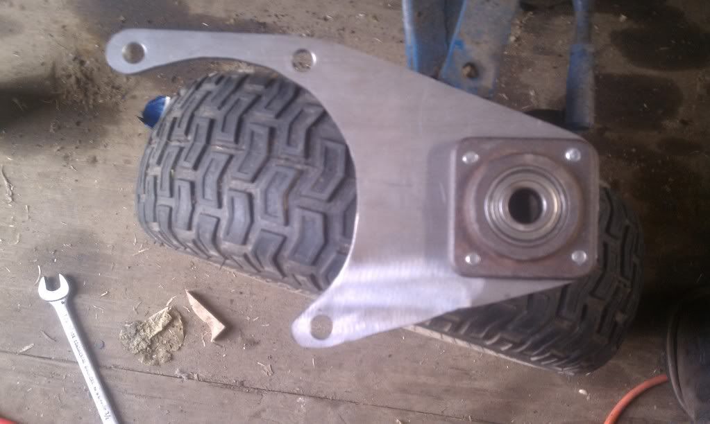

If you still need one, I could take it off and send it to you. That one looks like the tensioner pivots off the shaft. Mine doesn't. Could do a CAD drawing and send that to you. Let me know.

It is going on my 125 , I'll let you know, I think I have a pretty good idea as to what I need. The support bearings are my only concern at the moment, they may take some fiddling to get positioned proper.
Question: what does the end of the shaft look like? Does it have a key slot and cross hole ? And about how far does it stick out?

If I remember correctly, only a key slot. I'll see about the measurement later, taking it from the rear side of the plate. Possibly a couple pics, too.

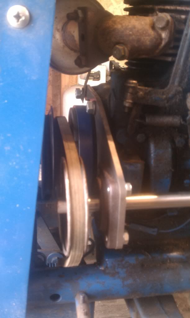

Posted February 06, 2012 - 05:46 PM
Okay, got some measurements. My PTO is the same as this. Pulley is 4.25" D. Shaft is about 2.5" ahead of the back side of the plate. Bearing stand off is .75" from the front side.
Need any more info?

Thanks Kenny, that's takes care of the goesinta now I need the goesouta end, this should have the cross hole for some sort of cotterpin ? This is where I was wondering if it was also keyed :thumbs:

Yep, got a key there for the u-joint and a cross hole to hold it on. I'm using a cheapy 1/4" bolt, double nutted. Bearing mounts to the back side. Guess I should have taken a shot of it. I'll get one later.

Thanks Kenny, that's what I needed to know,

I'll get a pic later, just so you can see what I have. One thing to notice on the front(PTO) end. One bearing bolt is right at the points cover, had to cut that one off so it didn't mash the cover.

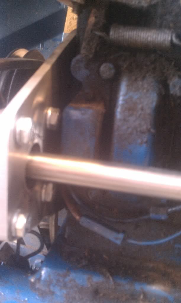

Posted February 07, 2012 - 12:27 PM
Here's a pic. I have the key wrapped with black tape so I don't lose it. Shaft sticks out about 2.5" again.

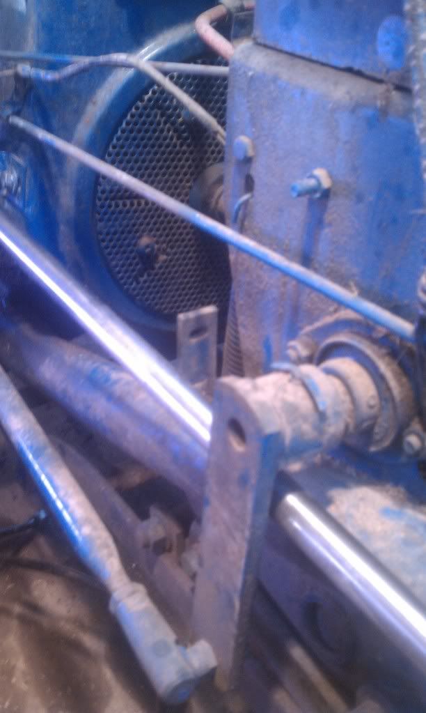

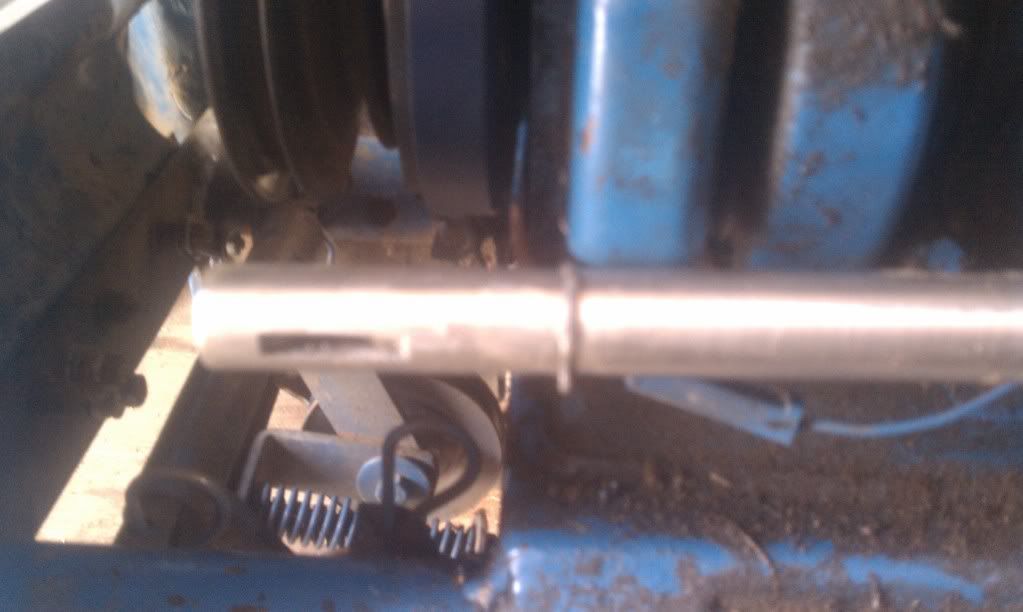

Posted February 12, 2012 - 07:03 AM
And a shot of the shaft with the key slot cut, and snaprings so the shaft can't slip forward .
Now I need to figure out what they had for mid way down the shaft for supports and make brackets for them.

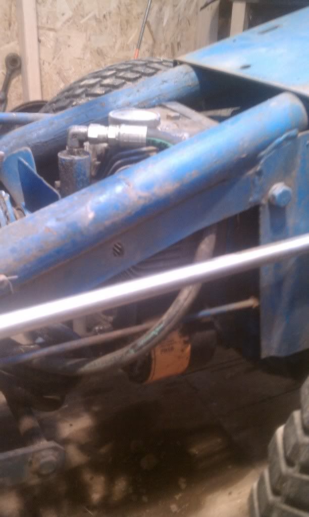

Posted February 12, 2012 - 07:28 AM
Is this an open side tractor? they were a bit different from the closed side if I remember correctly. Mine has 2 of the bearings supporting it, one under the gas tank and one under the fender pan about even with the front of the seat. They used wood blocks for some of these for spacers, I used strap iron and washers. The rear strap needs to be a little longer to reach up to the hole. I just kept shimming until I could turn easily by hand and knew it wasn't binding.
