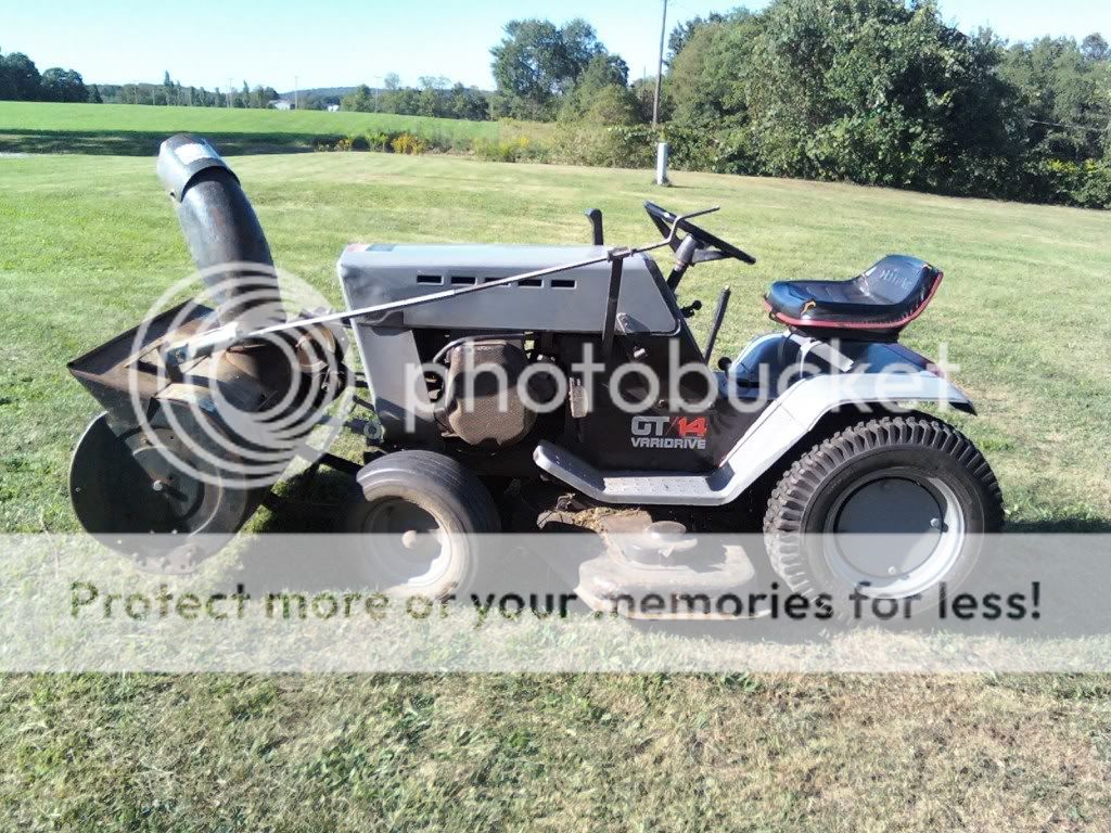

I paid $300 for mine with wheel weights, mower deck and snow thrower.
Here it is as it came off the trailer.

looks just like mine how does the belt go for the deck
