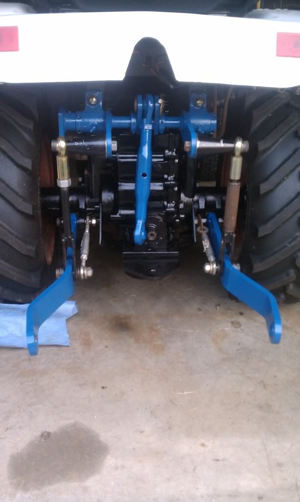

Posted August 18, 2011 - 08:59 AM
Update: So far so good. Need to shorten my top link (not shown) and extend the top lift arms for more lift, but works well. Also need to make a separate lever for the link to the cylinder. Probably only a few hours of fabrication left then I can get on the painting.

Posted August 18, 2011 - 10:39 AM
Just move the holes in on the bottom arms closer to the tractor end, this will give you more lift travel.

Posted August 18, 2011 - 03:27 PM
well that's a hell of an idea! Thanks skyrydr2!! Will do tonight. It would probably be good to put a few holes along each bar for height options anyway :)

Posted August 19, 2011 - 02:45 PM
latest updates to the hitch. Added top link, moved the rigging screws back on the lower bars and added a lever on the hydraulic lift.
