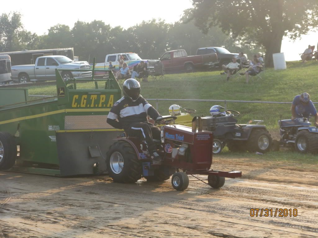

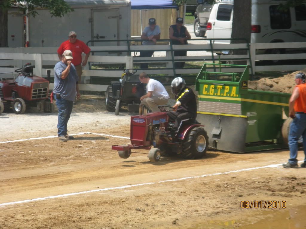

My 12 hp cub at play,Mama Tried.

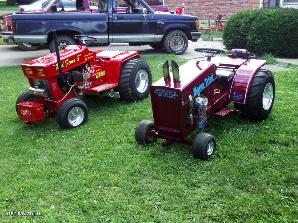

Both my cubs

Neat picture. Thanks for sharing.

Cool Cub. 12 HP does a lot of work, don't it?

Thanks.i pull with Commonwealth Pullers in Ky.This is a old cub,in mane only.I pull 12hp stock,but stock means it can be builtbored,ported polished,zand can run high octane fuel,in the stock altered class,alchol is allowed for fuel.This one,30 over bore,ported polished,gm points,bosch coil, on airplane gas.rear tires,26x12x12 carlile. fiberglass frontend,midwest supercub 4 puck clutch,midwest hitch,and with mo on it,950 pounds max weight. i dont if I am allowed to do this or not,but if not,please fix it.We have a website anyone can look at,you cant leave comments or anything,but it shows our club at various pulls this year.index1

Rick, It looks like you are using go kart sleeks on the front of the maroon tractor? Great looking tractors, Thanks for sharing..

Yup,Burris go cart slicks,lets it set lower in front to keep the center of gravity down,plus help keep wheelies down also...sometimes.

Nice Pulling Tractors!
