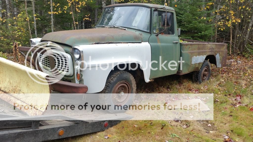

So I had purchased a 1960 IH b120 pickup to plow with. Ended up having to pull the engine to do the clutch. Was waiting on beer weather to procede. Has a pretty wimpy Western plow that looked way too small for a 3/4 ton truck.
I always disliked the pk plow. Way too narrow and takes way to long to plow the powder. So I got looking for things to build a rear plow or even extend the pk plow... then it hit me, I'll use the plow off the truck. ALMOST a complete bolt on too. I removed the pivot pin and separated the pk blade from the plow frame. Slid the western into place, installed a new pivot pin and practicality done. All I have left is drilling a hole in the frame to add the lock pin to stop the plow from rotating. Also removing the backstop from the western frame to add to the pk and then the impacts won't put pressure on the pivot... like the factory set up. Best part, pull pivot pin... reinstall pk blade if a choose. Very simple.

Hi interesting set up how about some pics of the back side to see how that fit, but it sounds like it wnet very good, how big is that blade yea it may push the front some but it will work I have a couple of 5' blades for my PK's and they work good, like you say the 4' is abit small, on one of the blades I added a spill plated and that really helps.

I will get better pics once I get it back from the welders on thursday. It was a slick swap and I'll be curious how it does in the neXT stom. Sofar it's always been light and fluffy stuff. No doubt wet and heavy will be more of a challenge. I est the blade being about 6ft. Maybe 6.5. I already have chains and factory rear weights.

StI'll have to drill that hole for the lock pin

Hi graham, looks good thanks for posting the pictures it sure was an easy convert, if your front tires are get old you could replace them with tri-ribs have them on my PK's and they really make a difference for steering.

Posted February 01, 2017 - 01:03 PM
Mngb, my tires are only a year old, take offs off a trailer I bought that I didn't like.
Finally got a chance to try out the plow. 3 inches of fluffy stuff so it is by no means a stress test. The attack angle does need to change. It would hang up on a pebble and it's already close to strait up and down.
Good news. 3 swiped and my driveway was done in 10 minutes as apposed to 40 minutes.
