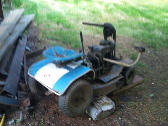

Here we go. Thanks for the help. Not too bad for a non computer guy!!!! Here it is??? Any ideas???
#8 caseguy OFFLINE
Posted May 26, 2011 - 11:17 PM
Interesting little critter! Definitely related to, but different than the one pictured above. Sorry that I can't be of any more help than that. I think it looks like a great candidate for a restoration though. Keep us posted on your progress!

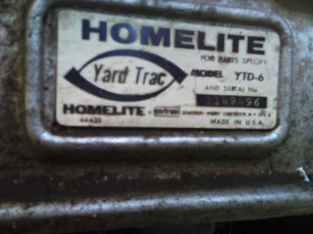

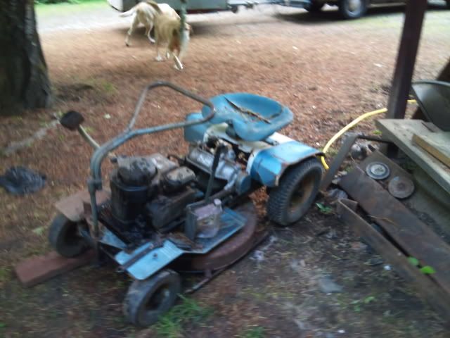

We got the briggs off of his machine the seats need to be ground but the cylinder and piston look good. I am just going to do a quick valve job on this little guy. While he get the mower painted up.
A local guy said this was made by Simplicity?? Any more info would be cool. This should be sweet to mow with reminds me alot of my Snapper.
There are some pics I snapped on Saturday before we yarded the motor on monday. ( I got married on saturday so no garden tractor work for me this past weekend but now I can finally focus on fun stuff again like GT's)
