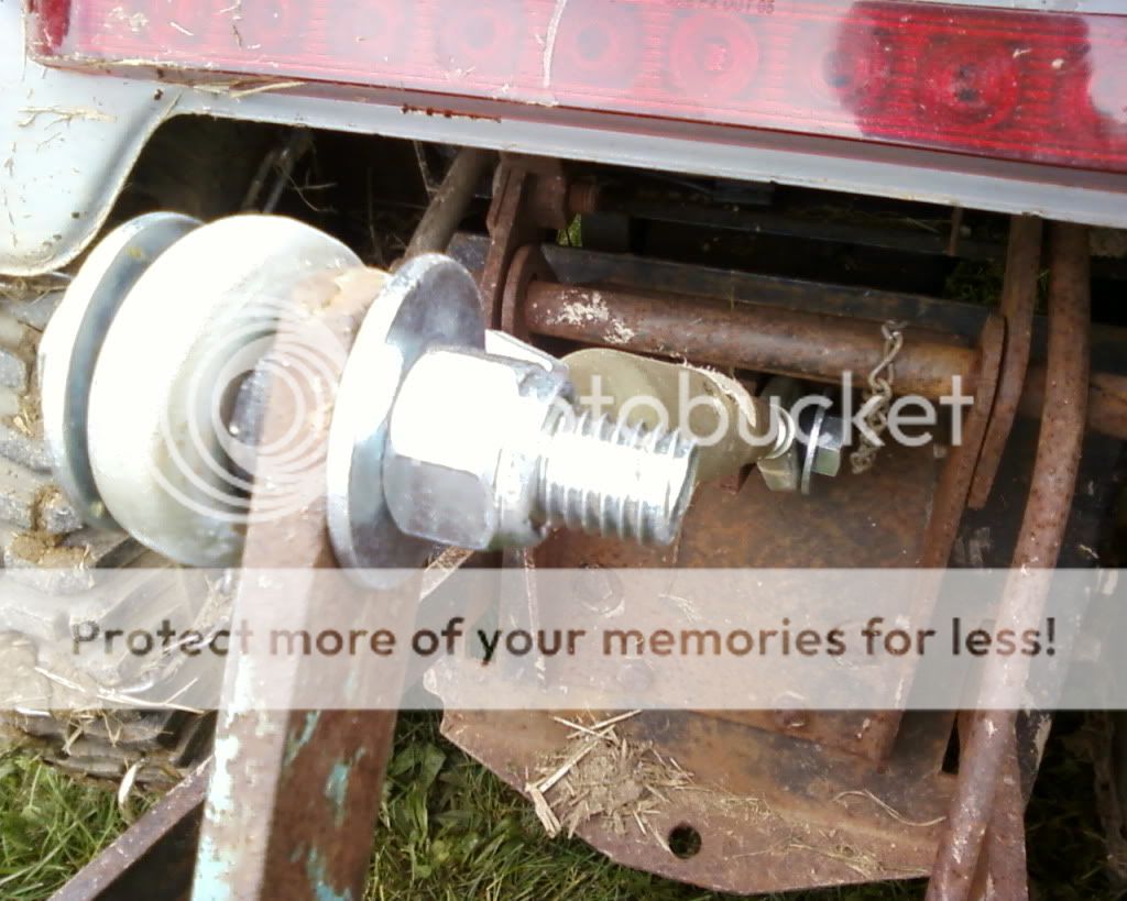

If you can't find an original Sears/Roper top link(which are adjustable), TSC short cat 0 top links work well, I have 2 tractors with those top links. I use a 5/8" x 2" or 2 1/2"(I forget offhand) bolt and nylock nut with a couple flat washers to help sandwich it.
BTW, they run around $25 or $30 or so.

Gibby, could you post a pic like the last one, only a little farther away? I would like to see how your handle clears that seat pan set-up. Seeing the bolt pattern, I have nearly the same rear to bolt to. Mine is an '81 GTV/16. I am still toying with this, just having a challenge figuring where to get the bends to clear the 26X12's as I want to be 20" wide for true Cat 0. Thanks everyone for the pics and info.

Posted July 18, 2011 - 05:41 PM
Let me know if you need any more angles.
Raised.
Lowered.
Raised from the side.
Lowered from the side.
