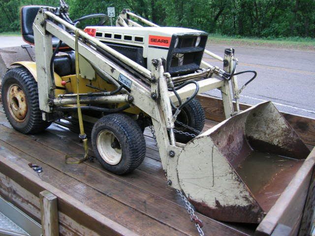

This ws probably my best craigslist find. It was advertised as Sears tractor and loader with a shot engine $350.00. I called the guy and made the deal to pick it up the next evening. He said the engine just lost power, but didn't knock or lock up. After I got it home it took just a few minutes to find that one of the screws that hold the air cleaner on had fallen out and got stuck in one of the intake valves. This held the valve open and the onan engine would hardly run on one cylinder. After putting it back together the old girl runs like a top. The tractor also has the electric three point hitch on it but with the cement counter weight on it the three point doesn't get used.
This rig sure is fun to use and has pretty much replaced my shovel and wheel barrow!

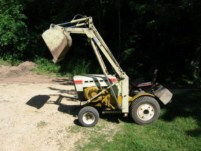

Welcome to the group Larry! To answer your questions, the counterweight is a piece of poured cement. It is enough weight for working on the level or going uphill put coming downhill I would like more weight on it. I have not put windshield washer fluid in the rear tires yet and that should give me an additionsl 50 pounds per tire.
The weight is attached by using the three point hitch. The drawbar hitch is useable but the weight is just high enough to clear the hitch of the trailer.

Caseguy, The loader will lift 500 pounds or more but you have a real hard time steering it with even close to that much weight in the bucket. The Sears has a pretty quick steering ratio and turns hard with a heavy load in the bucket. With a 200 pound load it handles well and steers ok. It still beats a shovel all to heck!
