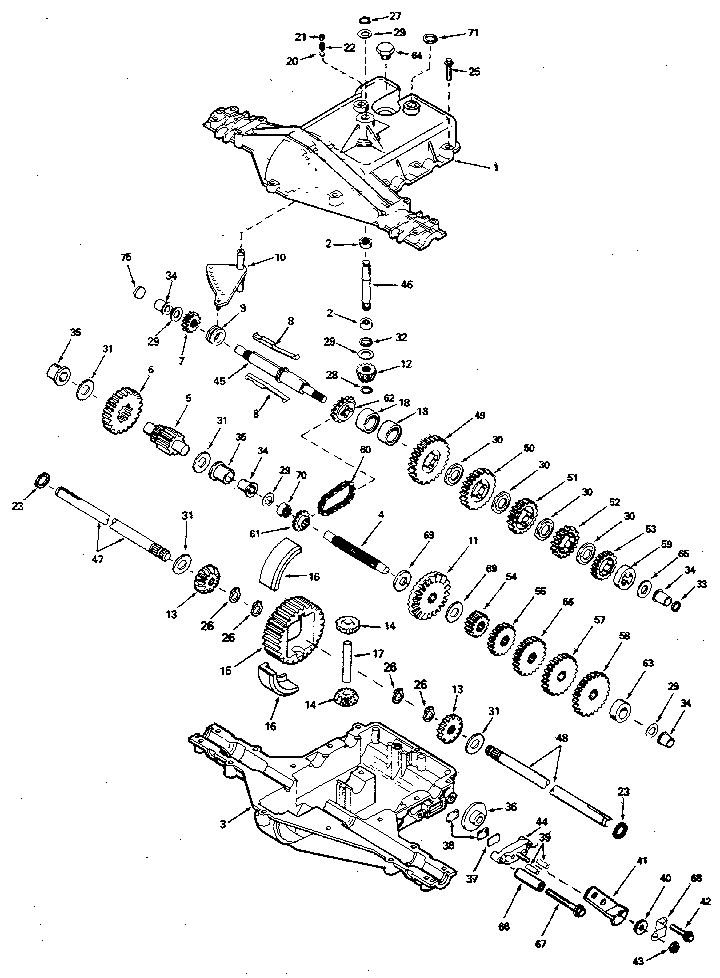

Transaxle is 920-012 Peerless
Can anyone tell me where in this parts breakdown is the axle bushing we talked about in the previous posts? The axle seal #23 but I don't see an axle bushing.

#7 KennyP ONLINE
  • 32,810 Thanks
  • 42,396 posts
Posted October 15, 2015 - 05:34 AM
#'s 34 & 35 are bushings.
#8 TAHOE OFFLINE
TAHOE
  • Member No: 24522
  • 7,324 Thanks
  • 5,362 posts
  • Location: "Hamiltucky" Ohio
Posted October 15, 2015 - 07:16 AM
Those are on the gear sets though Kenny, not actually on the axles.
If I remember correctly when I pulled my 6 spd apart, there were no outer bushings or bearings, the housing acted as the bushing, but I maybe wrong, it's been a few years.
