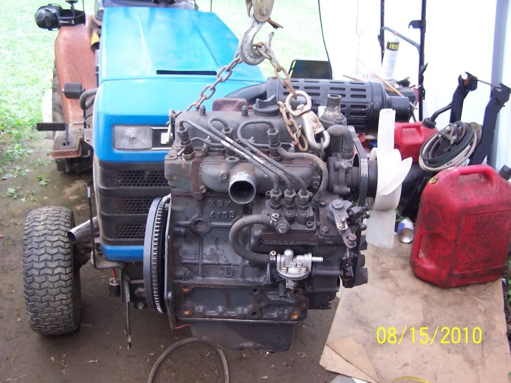

The engine I have is a 3600 RPM engine. It is a little taller, and a little wider than the Onan it is going to replace. On the JD318 there will have to be a little cutting of the frame. The base of the diesel is wider, but the mod will be easy. When I start the repower I will take a lot of pictures and post them.
As for the noise level, they are louder then the 3cyl. kubota, more diesel knock and the stock exhaust could be quieter. A friend of mine has one of these in a gen. set and it is whisper quite. So I know it can be quieter.

Now as far as ptos , most diesels have mounting holes front and rear to run goodies, mine is in backwards and drives the transmission off the crank pulley. This configuration is a pain for sure, if it were a Case, for instance it would much easier because of the simple drive.
