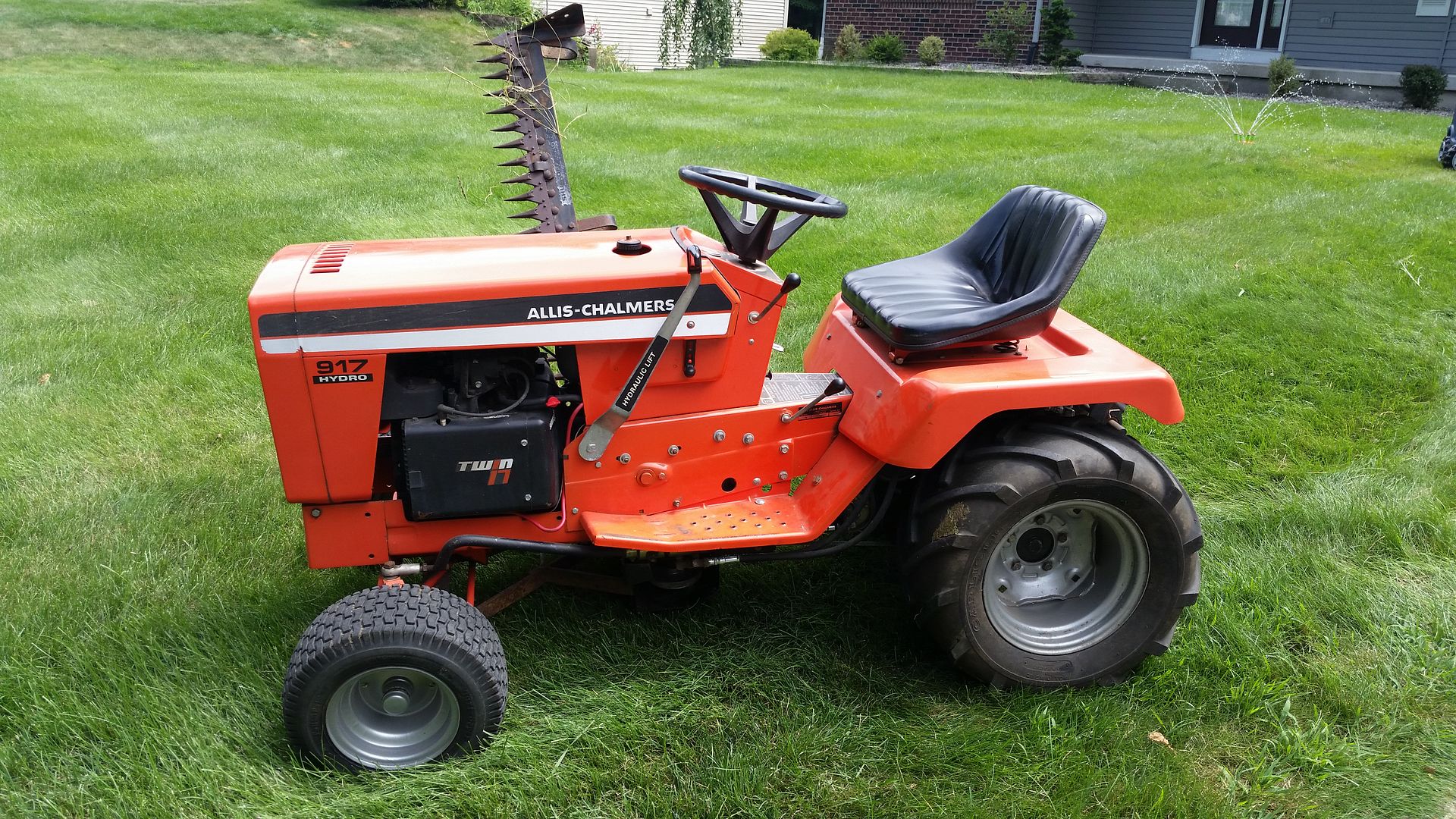

Well, I was able to snag a belt that works (46") and got everything assembled and well lubed.  The sickle turns easily by hand and I'm pretty confident that I have worked enough grease through the planetary now, that I should be able to give her a test run without concern.  My 917H is setup for the sickle still, but is my daily driver for mowing/vac'ing.  I'll be moving the lawn setup to my 7790 and mount up the sickle on the 917.

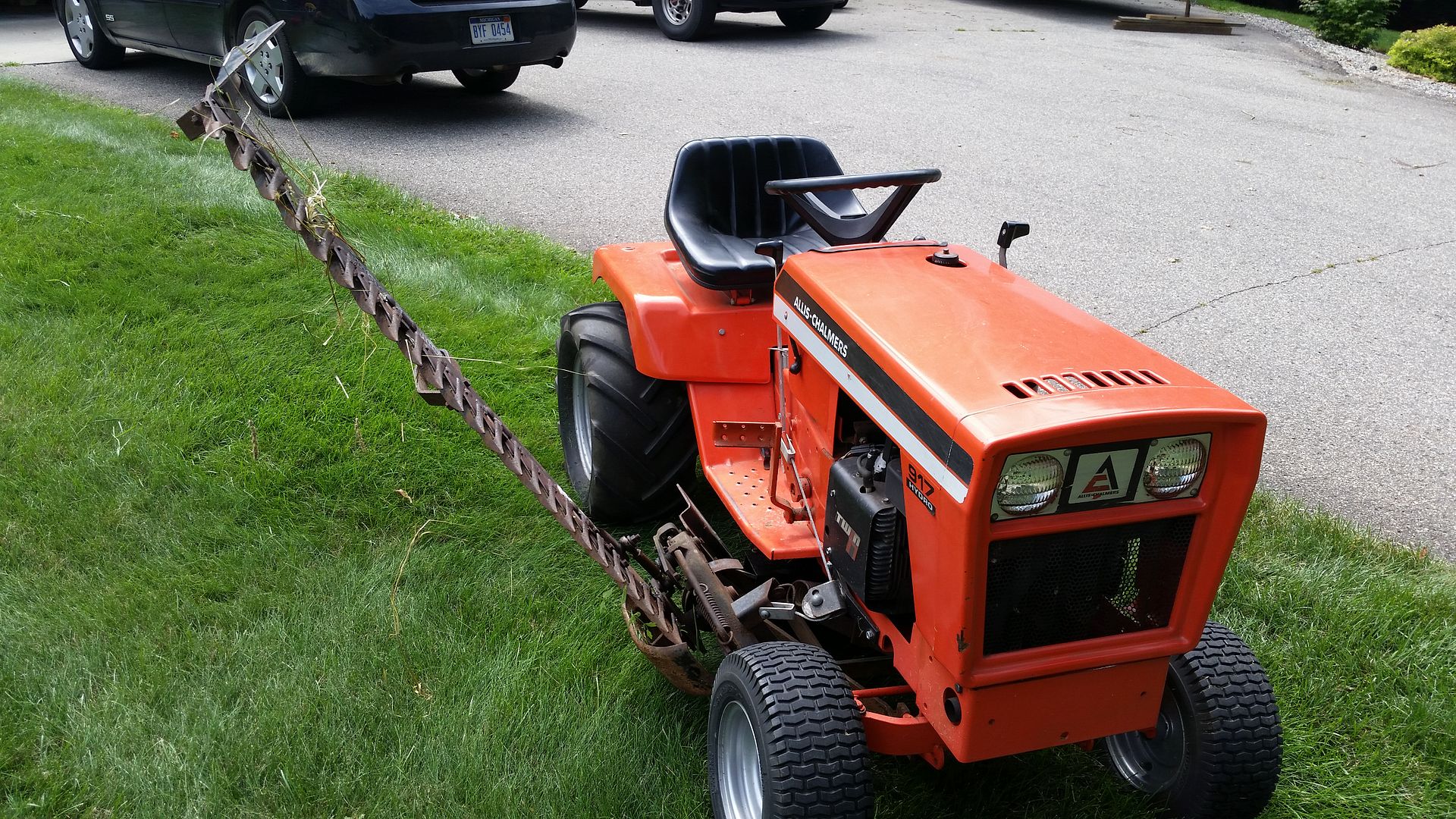

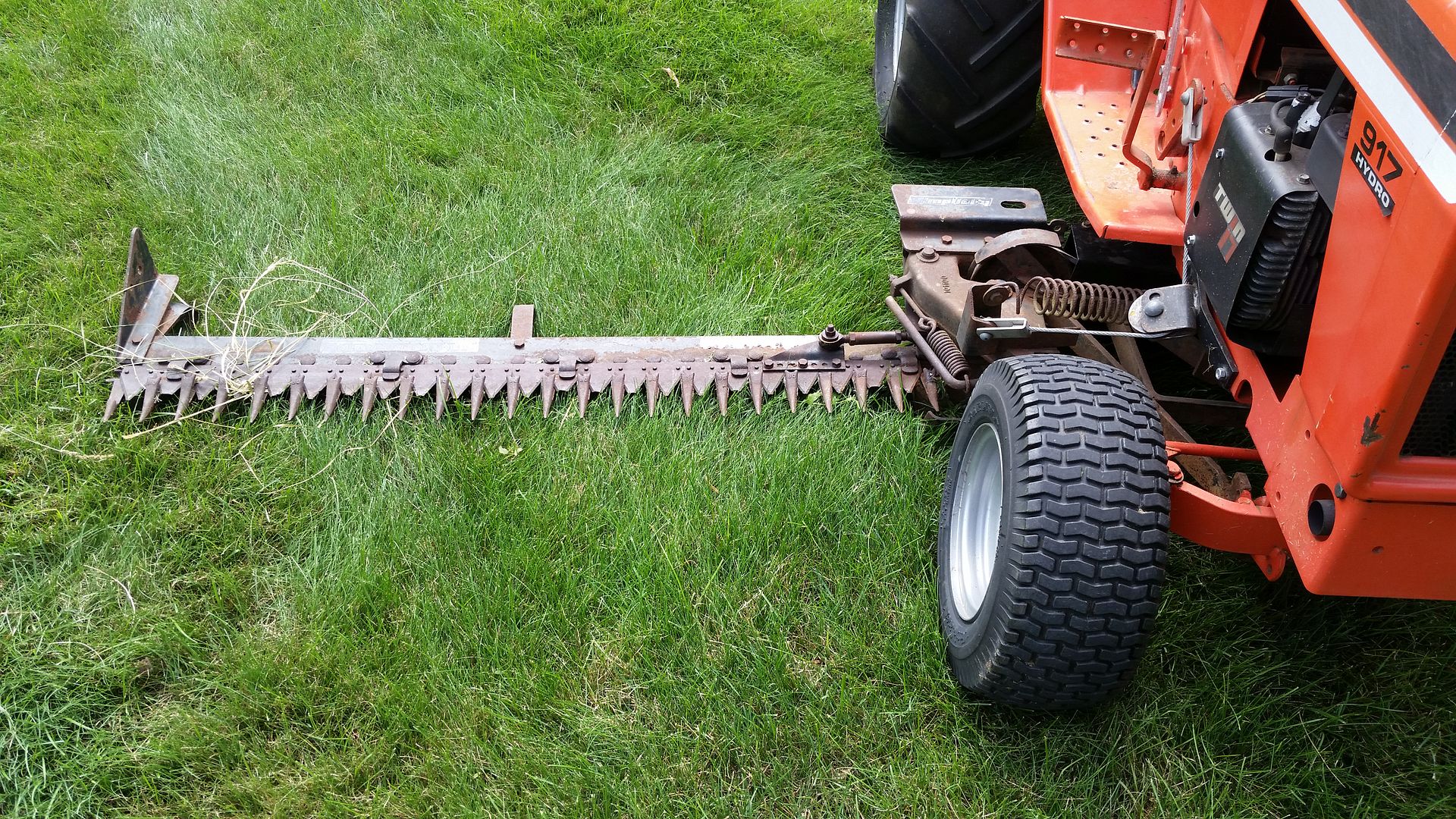

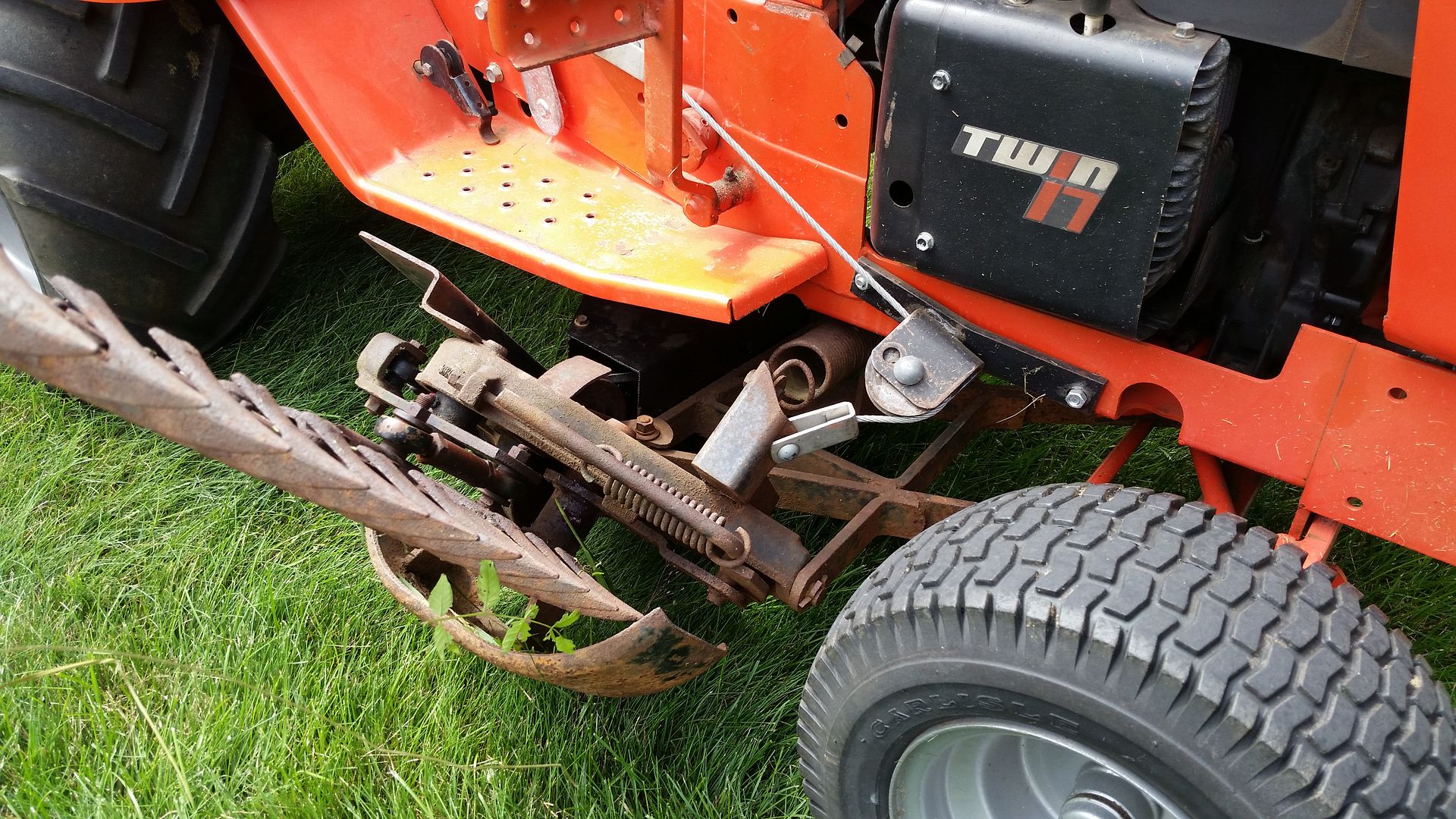

Well, I had 45 minutes to spare, so I removed the 32" deck from the Landlord and slid the sickle bar in place. It's awkward hooking it up, but it didn't take long. I installed the old drive belt, crossed my fingers, and engaged the sickle. The belt held up, so I grabbed a length of chain to hold the sickle bar up, then headed out to the tall weeds at the far end of the driveway. The weeds were about 3 feet tall and crowding the driveway. I lowered the sickle, engaged it, and took down the weeds. It functioned fine and that old belt held up. This sure beats the heck out of weed whacking. Just don't wear shorts when you run one of these sickle bars around cow itch. Yup I just learned that, HA! Here's a couple of quick pics I took afterwards.

Well, it's done...and it works!  I ran it for about 10 minutes, and it seems nice and tight with no funny noises.  I had to get the belt adjustment just right, which is a real pain when the mower is on the machine, but she's finished now.
Big thanks to Kenny!  I'm quite pleased to have brought this back into service.
