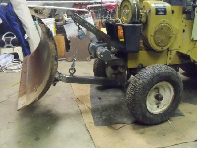

Here is what I made with my HB welder, been going strong for 3 yrs pushing snow, dirt and even lifting 300-350#'s of dirt/gravel ,etc.
