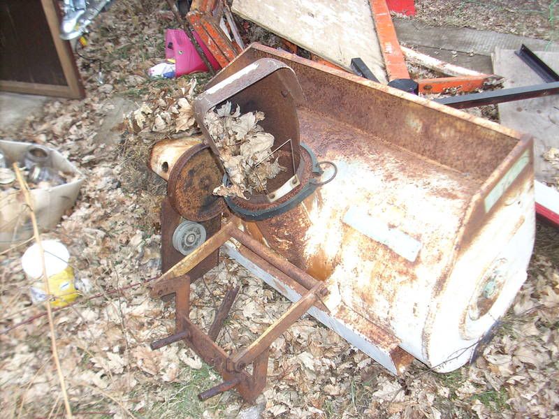

Had a brain wave.....I know, dont hurt yourself......lol.....I have a snow blade on my LGT Ford.....I was thinking that it would be nice to have a blower on the back for when I need to blow snow into the bush...It would be driven off my tiller PTO.
I know I am going to have to fab this, so was wondering if anyone knew of what type of blower I might use?....I am looking in the ads, This ad says its a Ford LGT blower, but I cant see how it can be driven by an LGT, not the way the engine and pulleys are set up...Any comments on this?

Hey Poncho if your going to use that blower then you'll need to use a angle gear box as well.What you can do is look for a two stage/dual stage blower.You might beable to just hook your pto shaft straight into the center shaft of the snowblower.Its all going to depend on the RPM that your pto shaft is turning.What you want is to have the shaft that goes into the blower turning as close as you can get to 1000 rpms.The other thing is a dual stage blower is less likely to plug.I had used a massey single stage blower one time on the back of a Simplicity GT and just had to make a frame to hook it to the back like what the tiller mounted.The belt was a easy hook up as it was driven off the same place that the tiller was and the pulley was even in the right spot on the blower.It worked pretty good however that was 30 yrs ago and my neck didn't bother me like it does now.Didn't have a cab either and blowing snow in -20 didn't seem to bother me either.Larry

Thanks Larry...I was just using that picture as an example.......I know it would be a pain to use it. ....I will likely comb the garage sales in the spring looking for something that will work. Its just an idea right now,,,,My PTO turns the same speed as the engine...will have to consider that as well as what direction everything needs to turn.......lots to think about. I have a blower on my Massey 10 now, single stage....it does a decent job for what I am doing, but just the thought of having all in one unit is cool too.
