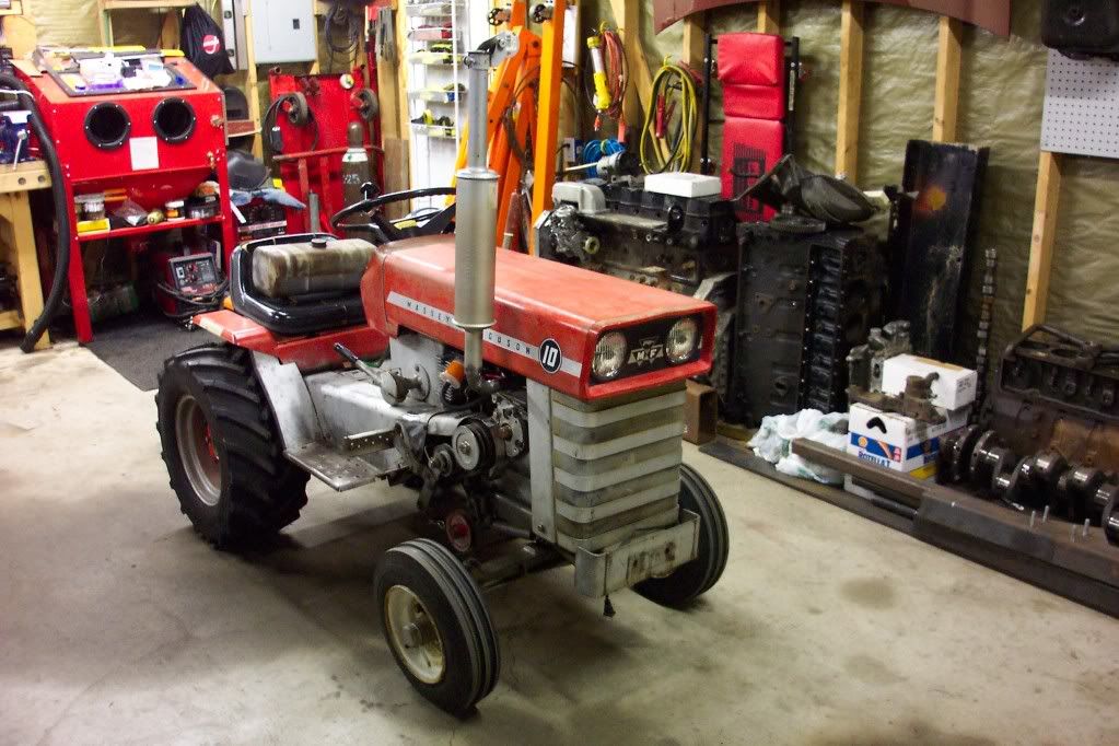

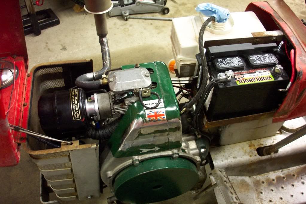

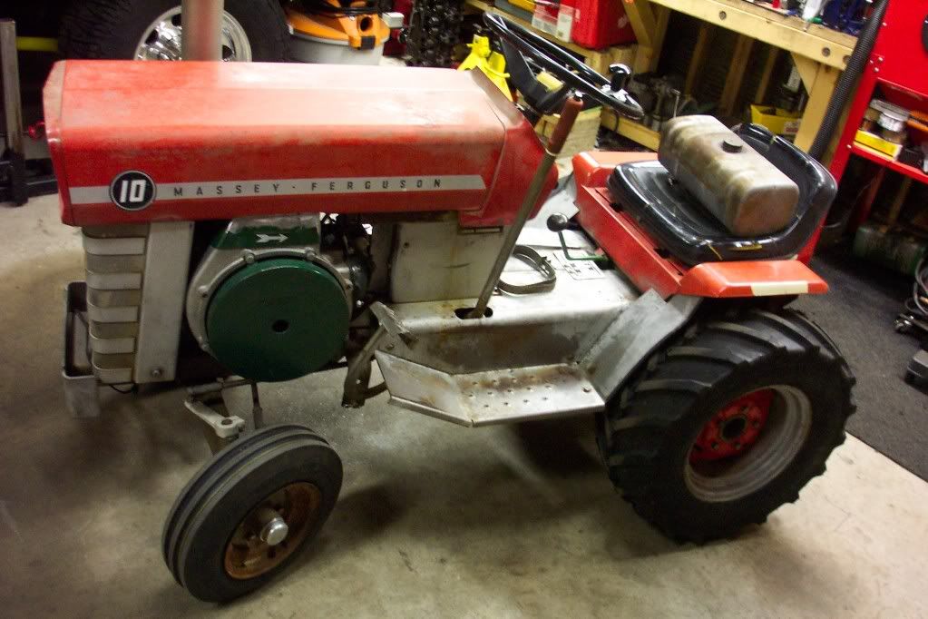

It is an AC1, 1 cylinder air cooled, OHV, Bosch direct injected, 3600 RPM. It is military surplus, It'll roll coal over the house like a freight train if its really working hard. This conversion has worked well for me, it was forced into service early and has performed well. These were taken when I was working on the swap. It's a tight fit. The gas tank in the pics is no longer, replaced by a stock steel tank modified with a return fitting.
I would like to get my hands on a 3-4 cylinder for a little fun with a turbo, some EDM'd injectors, and pump mods.

I haven't seen those pictures of that MF10 in a while,I like that conversion.

MF10,
Very nice. Looks like your tractor and the engine were made for each other.
Thanks for sharing!
