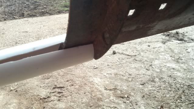

yes the pipe does try to slide.  so I drilled a couple holes and used a wire to hold it in place

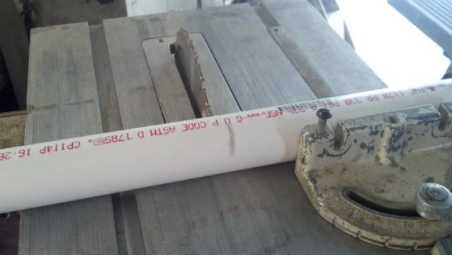

Looking at the pics, how about if cutting on a table saw, instead of just running thourgh end to end, Slide end of tube a couple inches past saw blade blade and then drop it down on blade to create a closed end on each end of PVC so it can't slide off.
Well, thinking as I type, may not work as it would be almost impossible to flex pipe enough to slide up over a double the thickness cutting edge than the PVC slot. Ok, so maybe leave one end closed and wire so it would only slide on one way.

thanks - I did not think about starting the cut a couple inches into the pipe
Just thinking out loud, may have to experiment myself.
When cutting the pipe if not doing it like Lyall described you might try putting the blade in the saw backwards? Making for less chance the blade will catch and tear out a chunk of pipe and fling it. I have a Vinyl blade for my saw but not everyone uses one and Have turned the blade backwards before I got one installing vinyl siding. (note that is a lot thinner than the pipe).

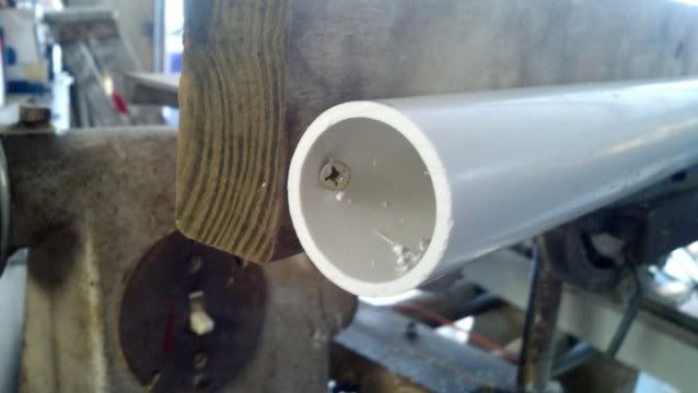

So picked up piece of 1 1/2" .Cut off end to length of blade. I decided against my idea of leaving solids piece on end. My luck, I would smack something and break it all apart, no overhang and slot  like I had suggested. Screwed to 2x4 and cut slot. Man a standard saw blade makes a mess, plan on sweeping up tons of plastic shavings.

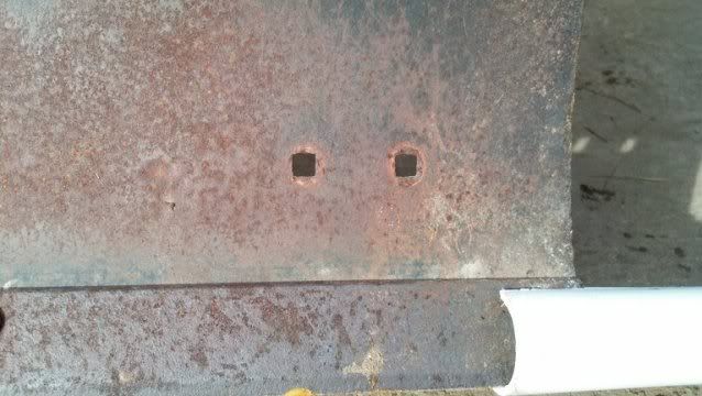

didn't look at my blade before doing this. My cutting edge is taller than the 1 1/2 so it wont' slide on top like I had hoped and I have support ribs all the way to bottom and also nuts sticking out the back from the cutting edge.
May work if I line it up, then cut slots for ribs and nuts and then slide from bottom up instead of trying to slide on long ways.

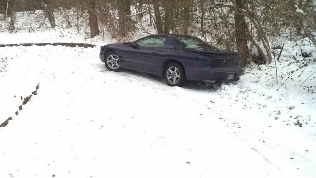

Here's the results of a no plowed, snow packed turned to ice gravel drive. I didn't have enough speed, tried to power up it and she snapped sideays on me. Tried to back down, but I was over too far already and it slid into snow bank even more. About 20 mins of digging, chipping, shoveling gravel, and a little tire smoking and I finally got it out.
