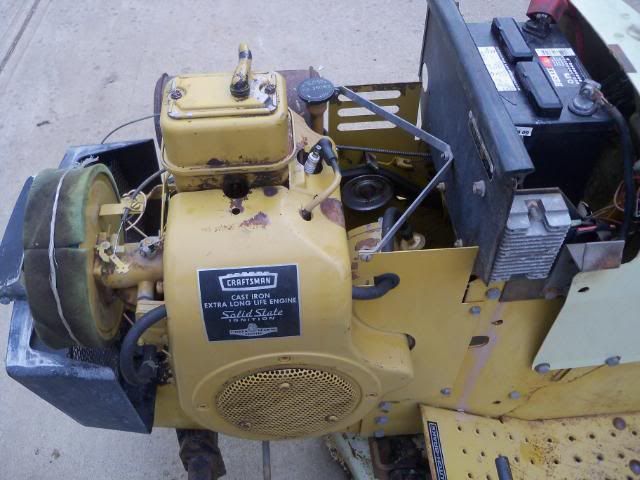

I will post a picture tomorrow when it is light,this ST-12 has a flat type head on the engine with a large horizontal muffler.Maybe mine is a early 1976 unit,when I have time I will scan and upload all the manuals. MMMMM snickers Cheers Mike

This is the engine must be an early one then.

I very well could be wrong, I thought Sears switched all the Tec motors in the Suburbans over to overhead valves in '73.
Then I've only dealt with my 68 SS12 and my 16's so have not dealt with the later 12's.
The serial number shows it was made in 1976 on the 316th day so that maybe a late '76 tractor. I was kind of thinking it maybe '68 year, but the starter, dipstick and genereal appearence puts in in the 70's era so probably original. Guess I learn something new too!

in 1973 only the 14, 16hp tec engines are ohv 12hp is still flat head
