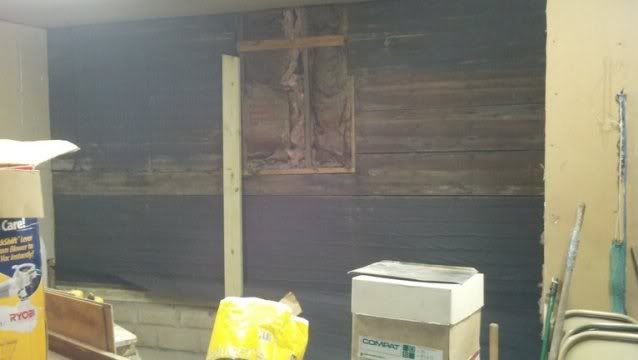

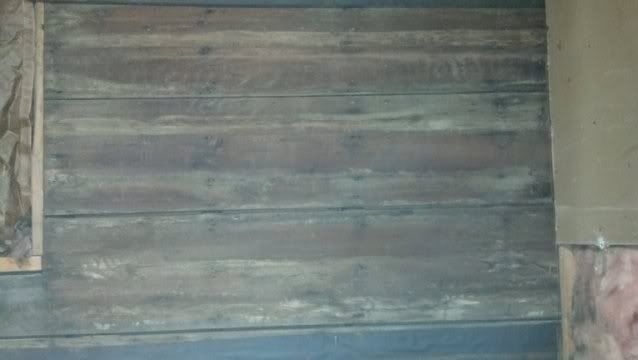

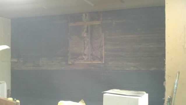

Finally, some more progress to update.
That no good, lazy bones worthless guy finally got off his butt and did something.....oh, that's me :D
Anyway, getting ready to expand mud room to make laundry room. Pulled the old house siding off the wall, took my time as I wantd to save as much as possible for future repairs I will need elsewhere on the house. Must be 107 yr old redwood, very dry, soft, and brittle.....and a ton of 100 yr old dust and garbage, glad I was wering respirator. You can see the roofing paper they used as a vapor/moisture barrier.
I also removed a small section of drywall to see what I have to work with and tear out.
Plan is to build new wall over to wear 2x6 is standing, that will be 5x8' extra, build new platform for new mud room floor, then enclose. Part of it will be a closet dacing into garage as that will become boy's bedroom also, doorway will come into it basically where corner of existing mudroom is.
Sorry about hazy pics, it's from the dust still in the air from me sweeping!

Questions
1. Picure 4 you can see the wide boards they used under the siding, there is no insulation at all behind these. This will become an inside wall ( living room on the other side), should I still insulate or just let it ride???
If I insulate, I plan to remove the very top board, get some of the blown in stuff then just push it down in there some how.
2. Picture 3 shows the foundation of house which used to be outside. I will bring drywall down to the top of that, wife and I think we will just paint it color of room and leave. If not, I will have to somehow frame out around it then drywall over making probably a little 4 1/2-5" wide ledge which I'm not big into.  The rest will be undr the mud room platform hidden. The outside garage wall is foundation also, but I can glue drywall under existing wall board and smooth it all out.
What do ya think?

Marty, sounds like a plan all the way around. Things to consider: those boards are wirer than a foot and old... May be a market for them.
The cement blocks will tent to have collect moisture. If wall boarding over, paint with dry lock first and/or use he green board.
What is the depth difference from blocks to drywall surface? You may be best off to just paint and leave, but if you want to hide, you can do a wainscoting around the lower 3' and have it come down over the blocks. Small chair rail at top and there is a lot of drywall you don't have to sand /finish.

Yea, I gotta drywall over them anyway and if I removed, sure would be easier to insulate, run my plumbing, etc.
My wife already has an idea to make a large old dining room table even though these would be too thin for that.
The newer cement blocks on the outside wall are above grade, they stay dry and I can just continue the existing drywall down over them with no bulge. I can consider still painting, I have some drylock form previous project.
The old block jut out probably 2-3" and they are uneven surface  as you can see. The other side is the living room crawl space which stays bone dry. You can see I left the last siding board attached, it sits flush on top of the block. If I removed it and the wide boards, then I will have about an inch of the top blocks sticking out. I will only have just shy of 6' of these block to deal with, rest will be under new laundry room. My son plans to use that littel corner cove to set up all his fish & reptile tanks so may just be a go to seal and paint.
I would love to wainscot everything, I hate drywall anymore.!!!! HAHA

Insulate absolutely everything you can, to the maximum extent that you can. Money saved in the long run. Pic 4, we call those Buffalo boards, because they're big.
What we're looking at there used to be the exterior, right? I would pull all the nails on the buff board, set the skilsaw for the thickness of those, and cut vertically over the studs closest to each side. That way they can be removed, r-13 or 15 added, 6 mil plastic over that, and then re-install the buffalo boards.
I vote for painting the block after sealing them.

Cat, yes this used to be ouside of house, now interior of garage since 1979 when dad built garage. It will be even more interior when I expand mud room and built bedroom in garage.
I started to remove them last night then realized they went up behind current mud room. I think I will wait until I remove that mudroom back wall and see what I got and wrok from there. If I remove the buff boards, not sure I will put them back up, just insulate and drywall over studs. I used sawzall to cut the siding off down the corners, almost cut through all the buff boards too :loosing_it:
