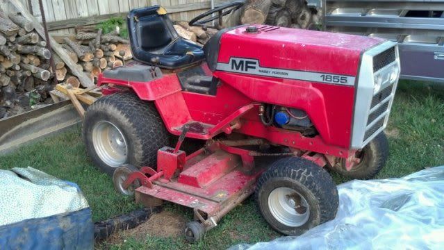

I guess I never have done an actual thread on this machine. I bought it last summer for $400 and then the problems began. You can read my thread about the Onan where I describe how I actually got it.
http://gardentractor...nan-last-night/
Here's a couple pics when I brought it home.

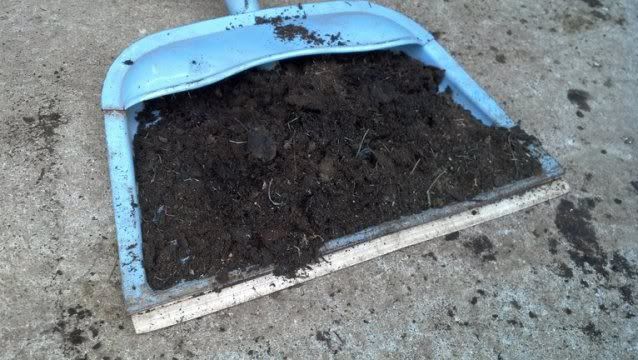

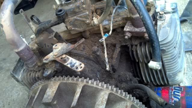

Due to lose starter, out came the motor and dirty one it was.
photobucket-8989-1366763783518_zps334877
Dirt scraped from motor
photobucket-15348-1366763832685_zps15c0e

Clean looking tractor. Boy I'd love that 3ph set up
I have no plans on restore right now, just get it up running and working. Plans are it will be at plow day next fall, gotta find a plow first!
I would like to get deck going for my field and plans are to make a small FEL for it. I already have 5' back blade in pics and a 54" snow blade I can make mount for. This thing makes my sears look little!
Previous owner use for last 6-8 yrs just grading his steep driveway after heavy rains....and I think to clean horse stalls. The "biscuits" I found on top of mower deck told that story.
