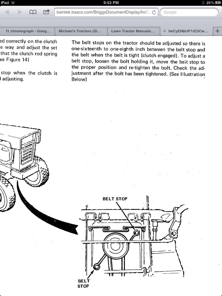

Maybe this will help.
79f3117d379047afa3de0f5ad3f1cb6d_zpsc206

With the pedal depressed I can not slip the belt by hand
Something isn't right with your adjustment if the belt is that tight with the clutch pedal depressed.
What manual are you using for the adjustments?  A System 5010 is model 1690007 and the manual is available free on Simplicity's website.  The pictures in that manual aren't quite as easy to see as the earlier manual, though.  I posted my Homesteader manual here on GTTalk's manuals section.  The graphics are a bit easier to see.  It can be found here:  http://gardentractor...0264-op-manual/

Thanks a bunch guys. I have the engine off now. The pulleys, both the drive pulley and the belt drive , are pretty rough and rusty. Actually one or both belts were stuck in the pulleys when I found it. I will clean and polish the pulleys and either clean or replace the belt. The one-sixteenth to one-eighth clearences were what I needed to know. I'm going to clean the engine and the part of the chassis under and behind the engine before I put it back together. Then I will do the same on the 5010. I need to get both  running and riding because I have two grandsons who will be needing a tractor to ride soon.Thanks again.
