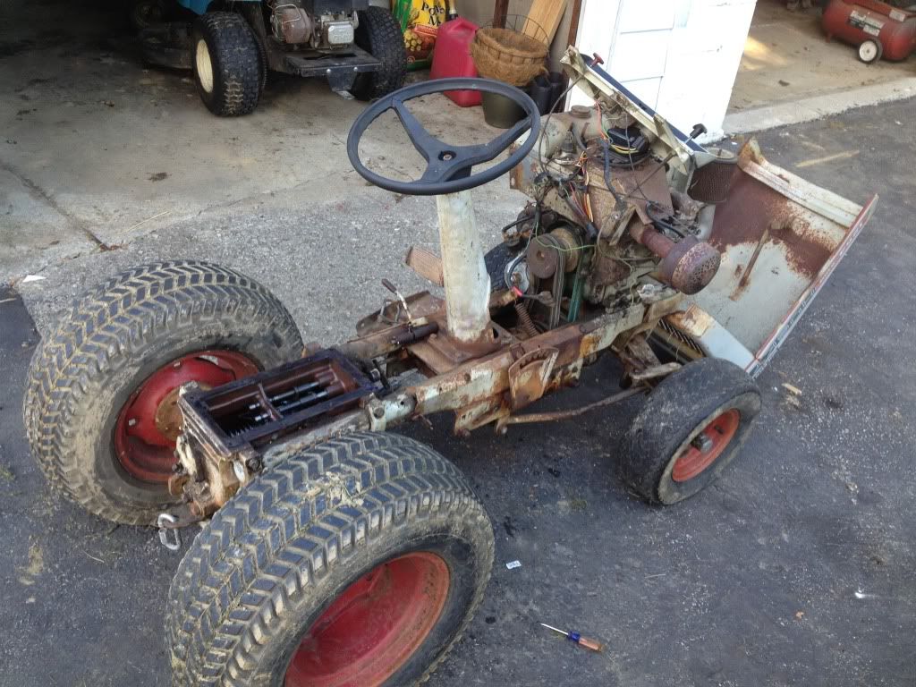

So I got out the 1254 yesterday to do some work (the input shaft seal needed replaced and reattach the pto lever) this is how I started Posted Image
By the time I got it apart I figured I might as well paint, so here is what I currently have Posted Image
My question is, how close of a match is IH white compared to the factory Bolens? Also, will a quart be enough? I don't want to put a lot of money into this, it's not a show piece, it's a work horse.

#2 olcowhand OFFLINE
  • 44095 Thanks
  • 32301 posts
Posted September 15, 2013 - 09:56 AM
IH White is a kind of cream color white.  I'd say not a good match.

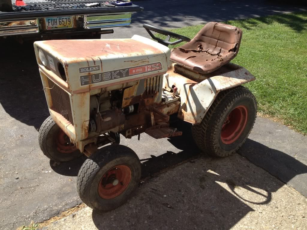

Me and Chucknbobs 1254s look to be in identical condition lol.
Here's mine.
Edited by EricFromPa, September 15, 2013 - 09:28 PM.

I have not tried to match this color yet but the white used for this time period was more of a grayish white (Not cream Color)
The picture of the Repainted one Ericfrompa posted looks like a close match to what the original looked like.
