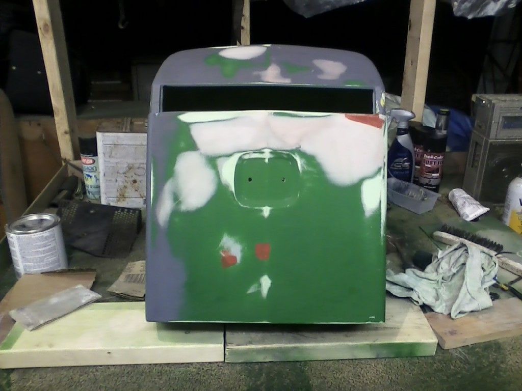

Have the hood painted. Needed the typical fiberglass repair to the front of the hood. Would seem as though I'm not the only one to miss the brake pedal and use the front of the machine as a battering ram.
Take a look:
I fiberglassed the rear of the hood, below the head light, 4 layers, just to make sure things stayed in place.

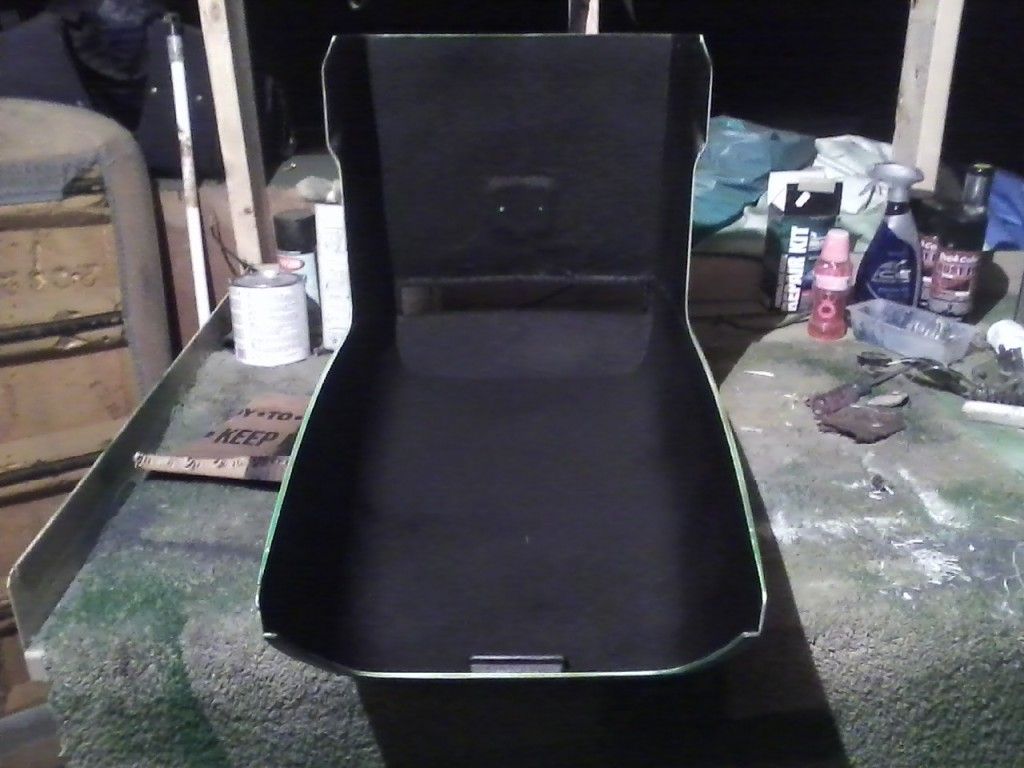

Here is the underside of the hood with non-paintable undercoating applied. It sets up hard like a spray in bed liner and I like the texture.

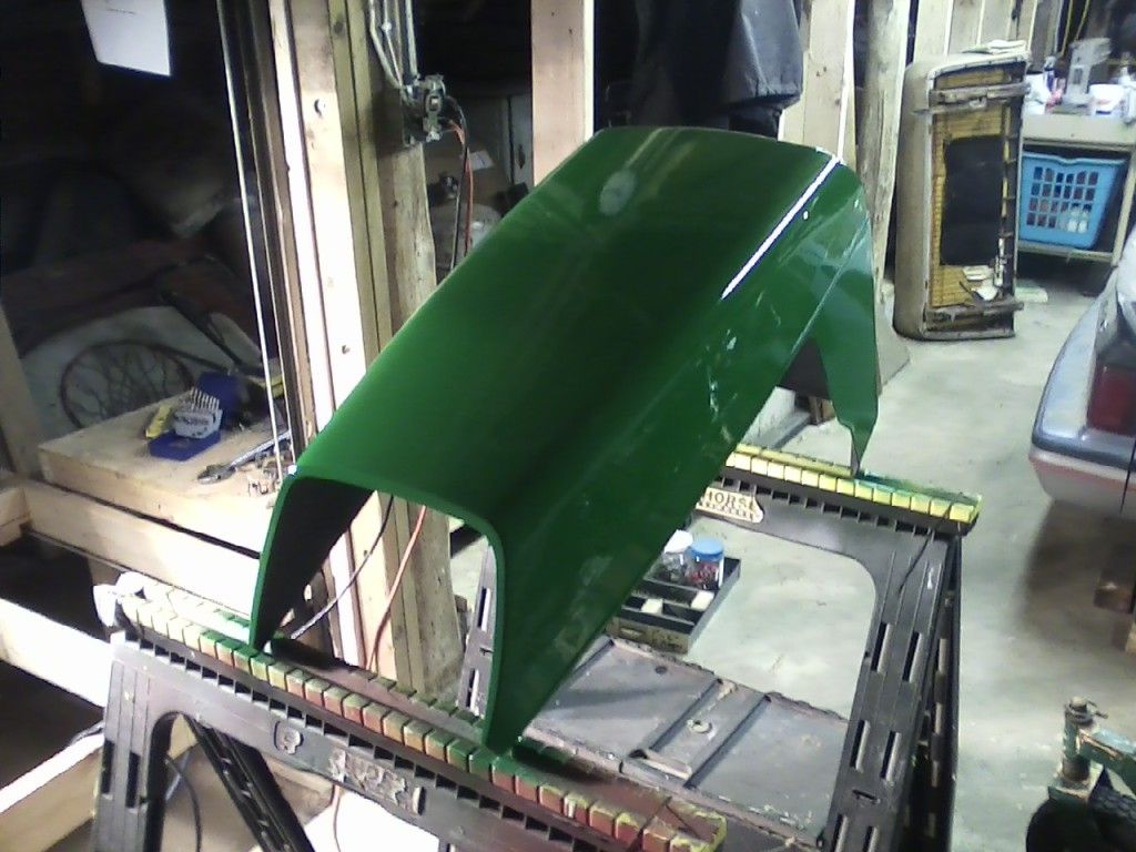

And the top side with a little JD green applied. Waiting for it to cure for a few days and I'll wet sand and buff it out for a little additional shine.
