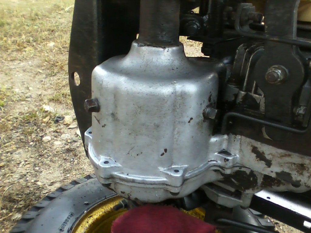

Rear diff is full ! :dancingbanana: The unit IS NOT sealed for life as I was led to believe from the JD dealer. Turns ot that there is a fill plug located behind and in between the lever linkage for the hydro and brake return lever. Nearly impossible to get to without turning the tractor on its' side, which is what I ended up doing. I used the drain plug as the fill hole, as using the actual fill hole, would have required a piece of tubing connected to the 80W-90 bottle. When on its' side, the two plugs are at the same level so there was no difference in the amount of fluid that the transaxle would hold, in either position.
Here is a photo:
You can see the fill plug on the right side of the axle and how it is level with the drain plug, when on its' side.
