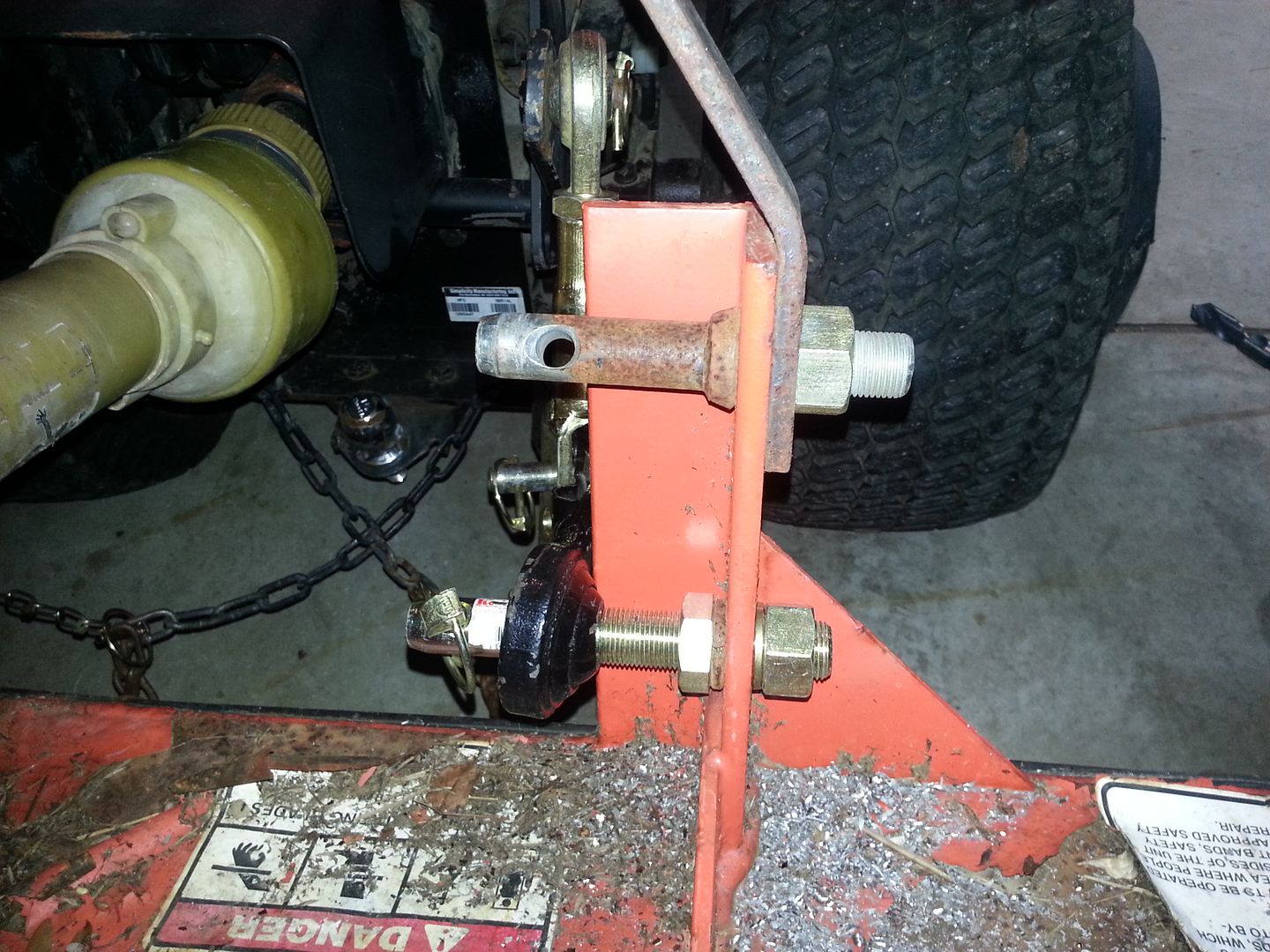

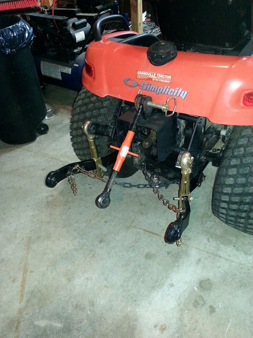

Oh man....I could go crazy here! Last nite I moved the mount points downward 4" on my brush hog, to get better lift from the 3pt. I was able to raise the rear wheels about 2". Now, they are waist high!
I had just wrapped up converting the Legacy 3pt from Cat 0 to Cat 1.
