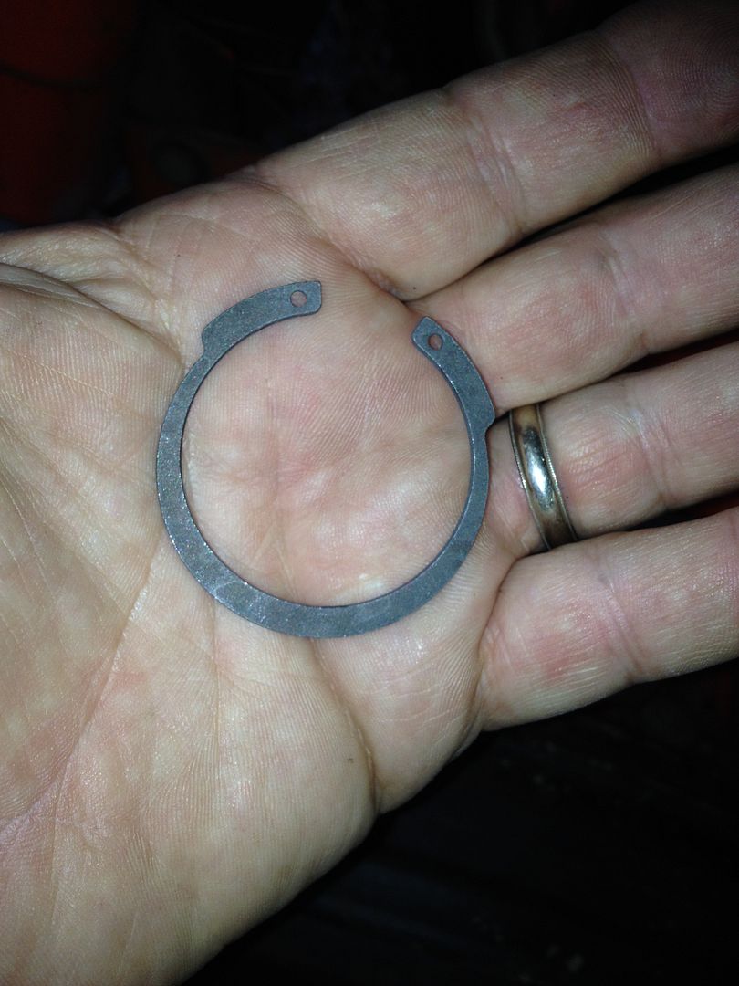

Worked on Clyde today.
I changed the fuel pump, cleaned the carb bowl, and main jet and replaced the intake gasket. I cranked her up and she started very easily. No more bubbles in the fuel line coming from the fuel pump and she seems to be running much better after warm up where before it it had a constant miss. I suspect the gasket was the source of the miss. I have been struggling with the K341 since the day I bought it. I may go out., put the mower on it and see how it does pulling a load. If its strong again I'll put it back in service so that I can sideline Sweet Allis for service so I can change out the shuttle planetary gear drum.
I am puzzled...What is this large external "c" clip doing in a sealed bag with other parts for a "K" series fuel pump?
