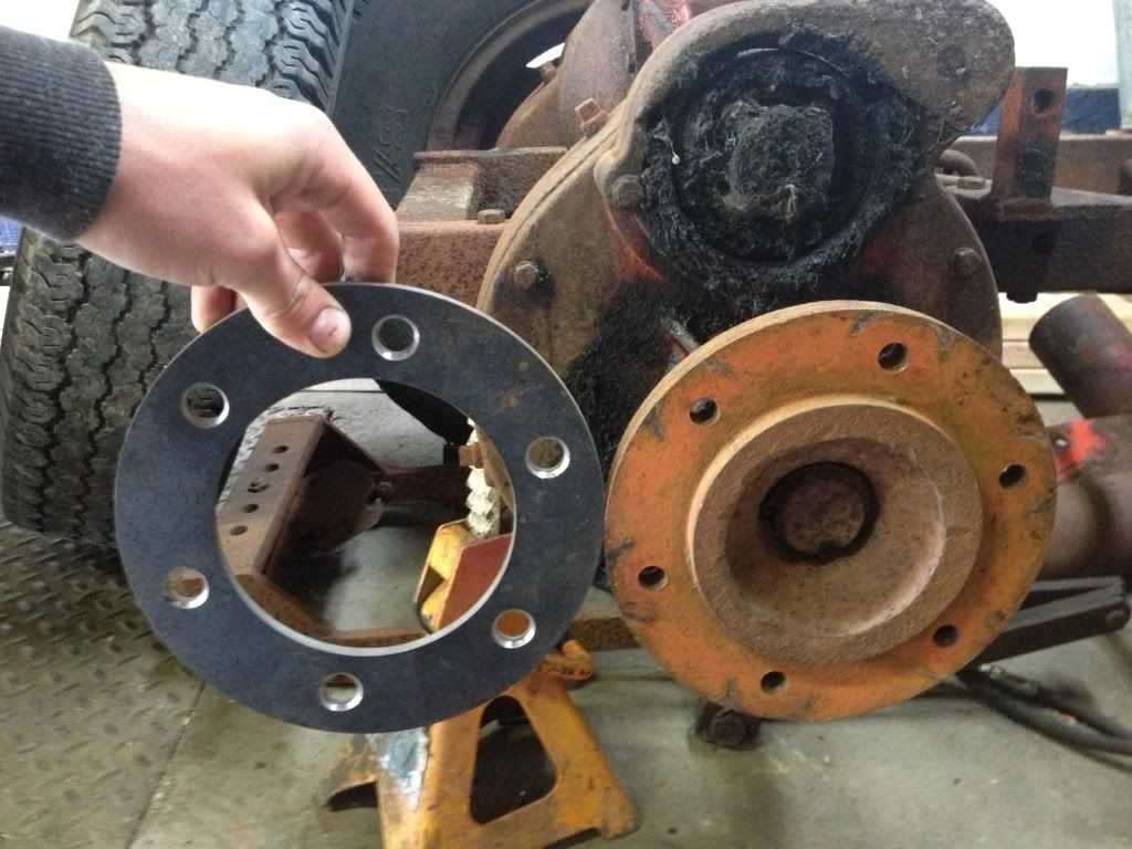

Back when I did a lot of tractor pulling, my Dad had some custom wheels made so that we could use 12" tires on 6 lug hubs; I don't remember what they where for but we ended up with these somehow. They are supposed to go over the center part, but they are a hundredth to small.
9023E97D-93B6-4907-B0BD-68BC4B1A4016-560
I was going to use them to make some spacers so I could get a little wider stance, but I found a problem. Even if they did fit over the center, I would  not have near enough room between the lug bolt to weld a pipe in as the spacer, and still have room for the bolt and socket.
40F4F50B-DE00-4234-B7EF-81EF36898015-560
I think that instead of messing around with the center hole and tight clearances, I will just remove the lip in the center of the hub. This way, I do not have to cut out the large center hole, which will give me a lot of room for the pipe in the middle, and I will have no problem clearing the lug bolts.
