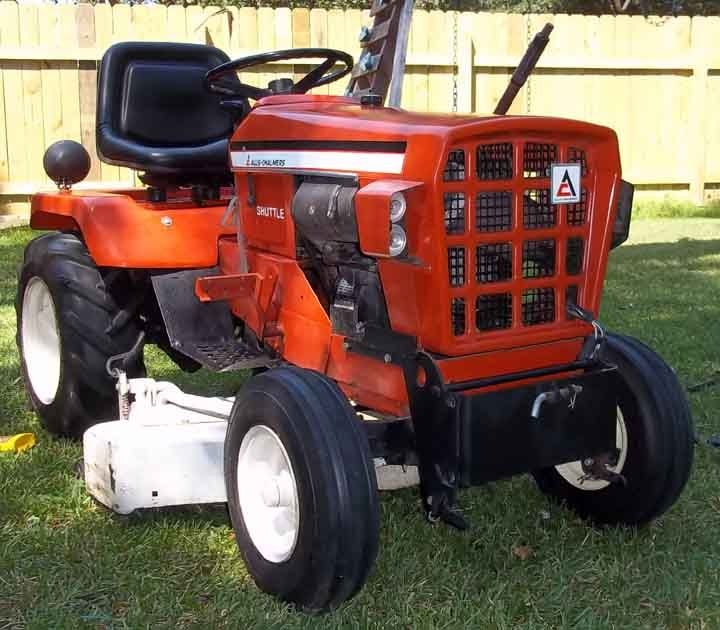

Well I made mine back before LED's were worth a tinkers dam. I rewire the socket to where both posts inside the socket were (+) ( right now one is positive and the other is a ground ) and I used 1156 bulbs (single contact) bulbs backed up with reflectors made from the bottom of aluminum coke cans. It worked pretty well until I got this new engine with an anemic light circuit. I am now looking for 1156 reflector LEDs. They are pricy but really save the amperage. 1157 bulbs are double pole but the bayonet lugs on the bulb will not match your original sockets. 713006d11540fd060a5850148eef7916_zpse9fa
I know, totally off topic, but whenever you post a pic I've been meaning to tell you, that really is a nice looking tractor. :thumbs:
Thanks! She is my baby. The 5 year old refresh is starting to get a little long in the tooth but she still looks pretty good.
