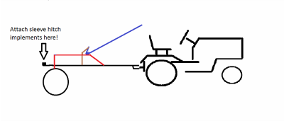

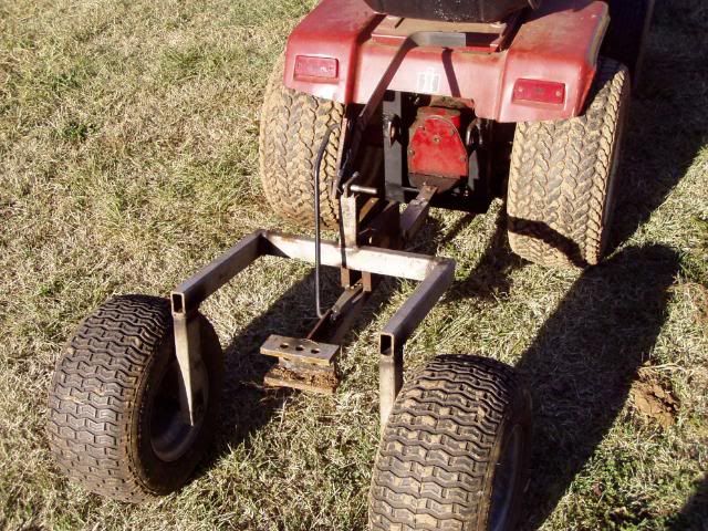

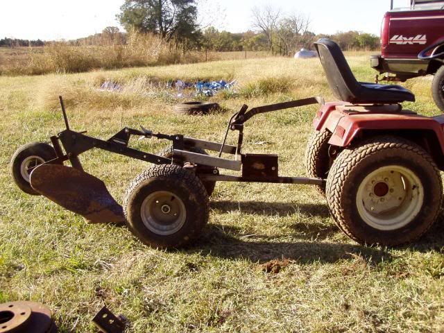

I may have what you are looking for!
I built a tool carrier so I could use my sleeve hitch implements with any tractor even without a sleeve hitch.
I have plowed some with it without problems. Even when I have to add weight, it is relatively easy to lift and lower.
I just kind of built it on the fly without measurements but I can do some measuring if you need it.
Hope this helps!

Now that is another neat idea! I guess which way I go depends on which kind of plow I can come up with. Your set up looks simple to build and should work out well. Thanks for the pictures.

Man that is so simple and works.

Petepete, what size plow is that you are using and what brand plow? Your design would be easy to put on an electric lift and battery. What other sleeve hitch implements do you use with your tool carrier? Nice job on it.

The plow in the pictures is a Craftsman. I think it's 10 inch.
I also have a roto tiller and single shank ripper I use with it.
And I first built it with an electric winch for lifting. The winch was mounted where the lift handle pivots and the cable went down to where the lift rod attaches. I still use the winch on it when I have the rototiller mounted just because it is so heavy!
