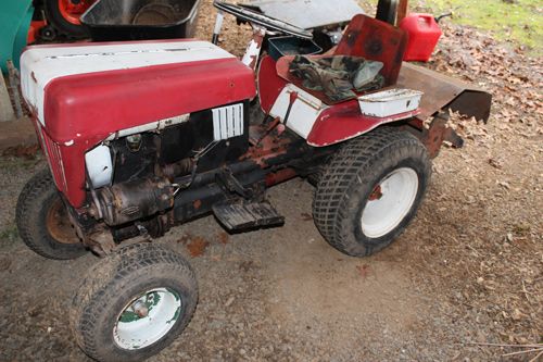

Is the spring assist there on the raise lever a normal thing? I haven't noticed that on other's pictures, and I have a sneaking suspicion that it's actually stopping me from raising all the way and letting the lever engage and actually hold the tiller high..
Engine:
Bonus Tiller
  • MailmAn said thank you
#21 Bruce Dorsi OFFLINE
Bruce Dorsi
    Old, but not dead -- yet!
  • Member No: 1525
  • 5122 Thanks
  • 2911 posts
  • Location: New Jersey
Posted April 11, 2013 - 12:55 PM
"Is the spring assist there on the raise lever a normal thing? I haven't noticed that on other's pictures, and I have a sneaking suspicion that it's actually stopping me from raising all the way and letting the lever engage and actually hold the
tiller high.."
That is not an assist spring.  .....That part is used when a mower deck is installed, and it will serve no purpose with any other attachment.
The spring assy is there to allow the mower deck to "float" over terrain.  .....The position of the lift lever will set the lowest position of the deck, but the spring allows the deck to ride-up over high spots that the mower deck's runners encounter.
There is a small hole thru the rod portion (approx 2" or so from the end with the nut).  .....When the spring is compressed, the hole is visible.  ....Putting a hairpin clip in this hole will keep the spring compressed.  .....This makes it easier to remove/install the spring assy.
....If you leave the pin in while the deck is attached, the possibility of "floating" is eliminated.
I don't remember if leaving the spring assy in place will prevent full lifting of the tiller.  .....Someone else may be able to answer that, or you can remove the spring assy and see if that helps.

If it's for a mower deck, (which I don't have) than it's not really necessary and could be removed? Guess I have some fiddling to do when I get home. Haven't had a whole lot of time to really go over it and figure out what's doing what yet :(
