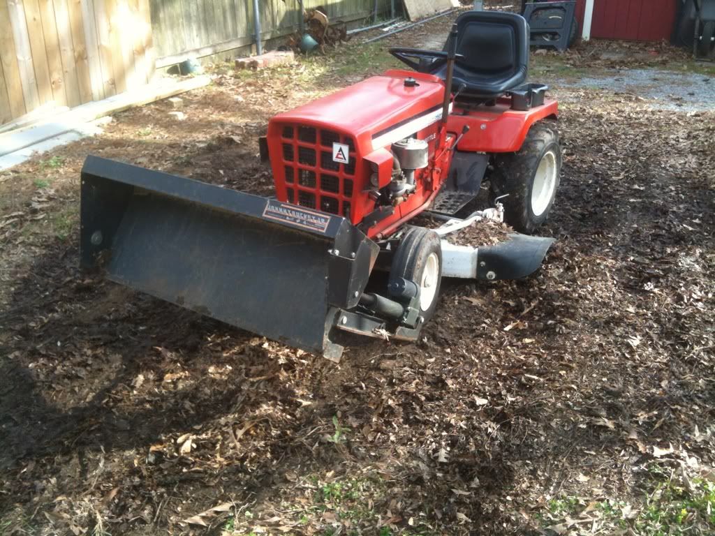

I have a Johnny Bucket junoir with electric actuators on dump as well as lift. It is great for what I do and I used it the first month I had it to move gravel (crushed limestone) under some temporary buildings at school where it was too tight for any other means other than wheelbarrow. It literally paid for itself within a week.
2AE92B90-F8D8-4ADE-ADFA-B6AE0D39B238-160
Nice thing about mine is you can throw it on the tractor and use it with the mower still attached.
  • boyscout862, twostep and TAHOE have said thanks

Posted March 03, 2013 - 12:49 PM
I'm in love with that Allis, very nice tractor!!!

BTW: Thanks, Tahoe, actually it is a Simplicity 3414. Sorry for the deception.
74f9613a45fc8df6eba0d8e92c897ace_zps27f4
That's okay, I'm still in love  :D
