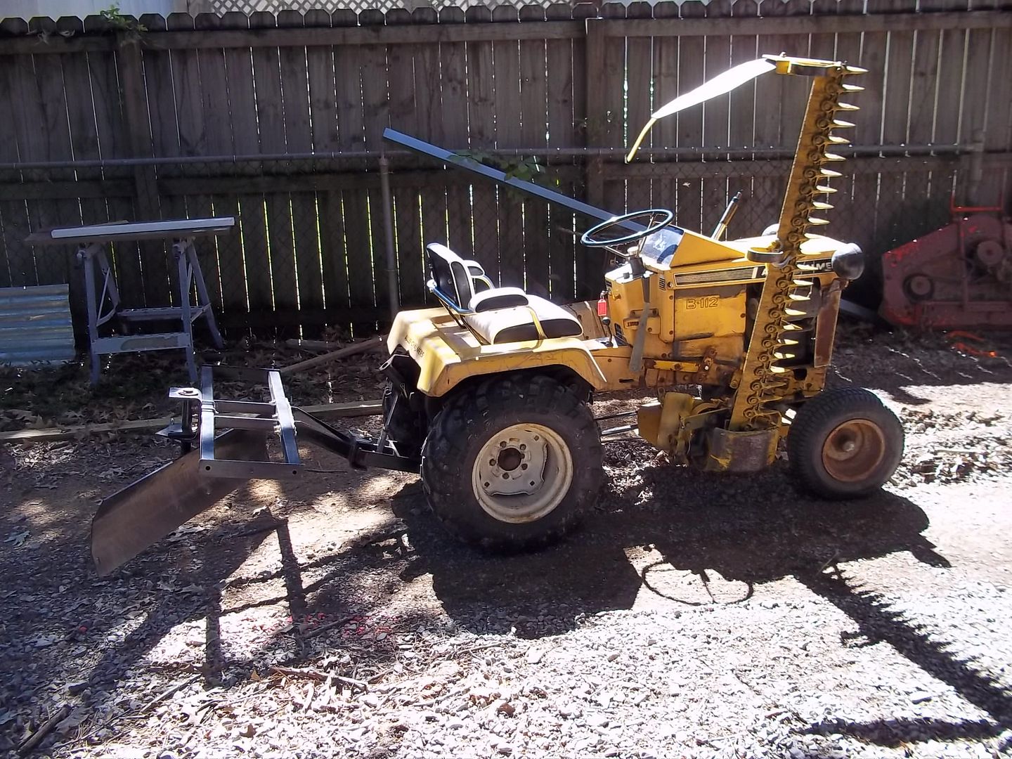

Heres my 210.   I been told you can use walk behind Sickles and Guards for it.  Sometimes Sandy Lake has a few parts.  I just ordered the 4 half bushings they had.  I need them on the Sickle driver.  Also tried to see if they had. An inner race on the pitman arm.  They get stuff in pretty often.  Id check Sandy Lake Implement nice people too!!!!  http://www.sandylakeimp.com/  They also have a Facebook Page.
