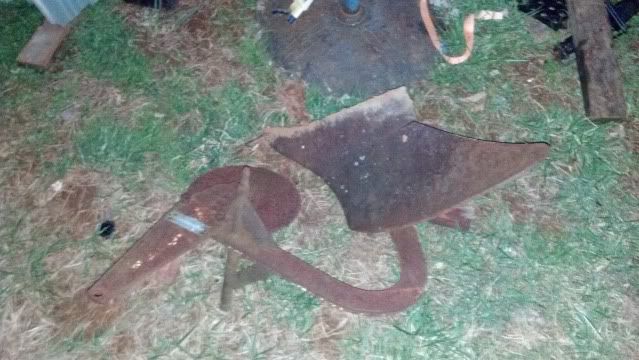

While I was doing that my buddy Reid dropped by to bring me a plow.
It is a 3 point Sears plow. I don't have the numbers off it yet. He also brought some misc parts for the Onan. He is pretty happy with our trade for the non working Plasma cutter and so am I.

Awesome is as awesome does.....and you did awsomely!   That should be an 8" plow.

I like your brake spreader, that is cool! Glad you got the brakes fixed.
I have a plow similar to that 8". I'd like to find another to make a 2 Bottom for the FF! Yeah, the tires are a bit wide for an 8" furrow, but it would still look cool!
