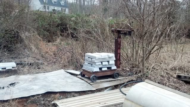

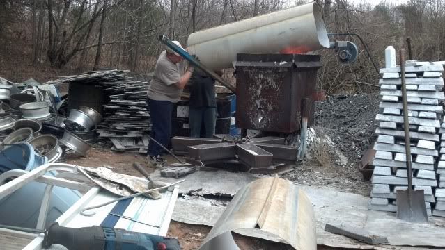

I have been there to drop stuff off before but never watched him make the ingots. I was curious as to how he was going to get 28 foot pontoons in his furnace.
Once I got there I met his brother in law who was helping him. The whole time I was there he was spouting one racist epithet or another, then he stated telling me how his son kept getting in trouble because of black kids. It was all I could do to not toss him in the furnace.
Anyhow, the sawzall came out and cuts were made and things started to melt down.
In a couple of hours we had close to 800 pounds of aluminum ingots. This pic is about halfway through the meltdown.
