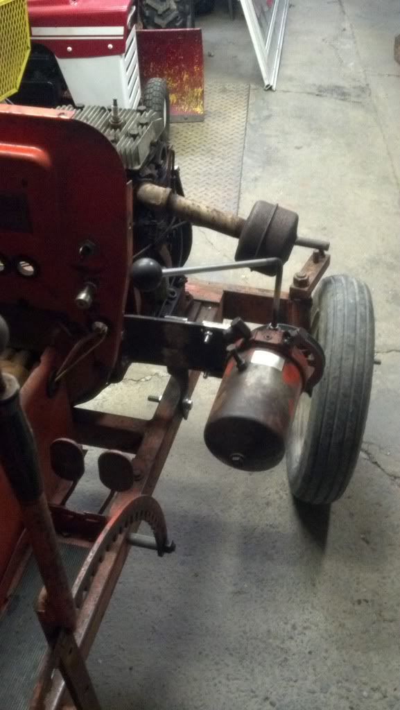

Here is the best picture I have showing the current exhaust on the '71. I am going to have the hydraulic pump there now, and the exhaust might make it turn color after a while, something I did not think about when I thought of the pump mount. It is deceiving in the photo but the hydraulic stuff is a little farther back then where the exhaust comes out of the block.

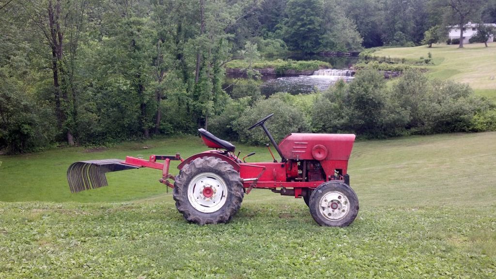

Here is the best I have of the exhaust on the '75. It works great, but it blocks the rearward hitch blocks.
I like the idea of keeping it in the frame like on the '75. But it would be challenging with the hitch blocks there, I might be able to get away with it on the '71 though.
#14 KennyP ONLINE
  • 35,164 Thanks
  • 44,160 posts
Posted November 11, 2012 - 10:13 AM
Does anything attach between the pump and axle? You can get a street 45 and screw into the existing ell to angle the muffler down/back a little. Could use a shorter nipple so it doesn't hang to low,
