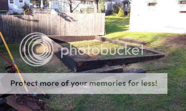

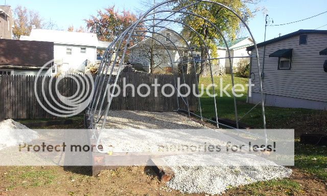

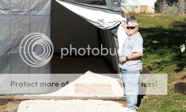

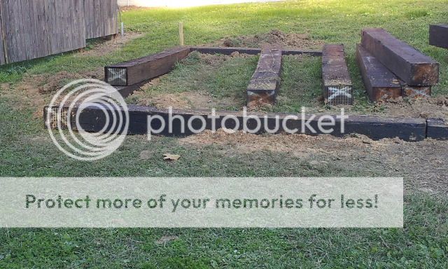

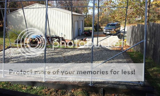

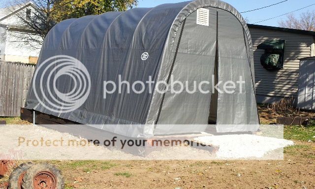

Needed more space for my Wheel Horses and implements, so we bought a "garage in a box".
I will let the pictures do the talking for now.

I have all the ties pinned together with re-bar, and the re-bar is then driven into the ground about a foot.
The frame for the garage is bolted to the ties with 5/16" lag bolts 2" into the wood.
