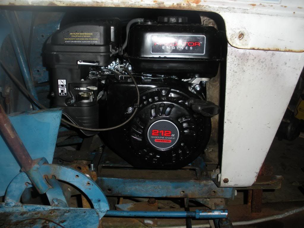

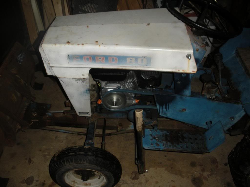

#15 bja105 OFFLINE
bja105
  • Member No: 10485
  • 196 Thanks
  • 191 posts
  • Location: Western PA
Posted December 20, 2012 - 09:37 PM
Here are a few pics, in the dark garage. I'll get better pics in the daylight.
I turned the muffler (almost) 90 degrees to get the exhaust out the side.
Under the fuel line is the throttle linkage. It is set up to easily attach a cable.
  • HowardsMF155 said thank you
