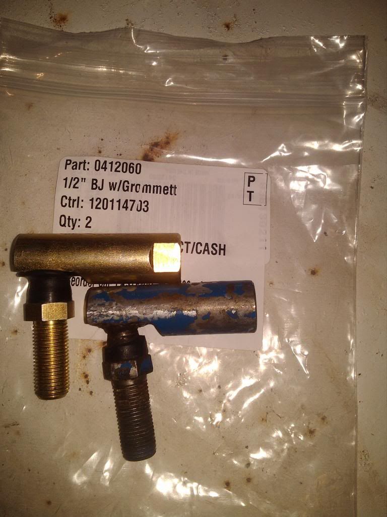

I broke a tie rod end on my Ford 80. It might snow next week, and its the only tractor I have at home with a blade.
The tie rod ends are larger than the ones Tractor Supply had for MTD, which also fit my IH Cub Cadets.
I ordered a pair from Fastenall, but I don't have faith in the counter guy. If they are wrong, does anyone have a source for tie rod ends for a Ford 80 or Jacobsen Chief?

Sorry! I was stressed a bit and I apologize. Do you have a JD dealer nearby? The tie rods for this are 1/2-20 threads. I think JD used these a lot. Might be the quickest way to get one if Fastenal doesn't work out.
Have you downloaded the parts manual for this? It shows the nuts that go on it as 1/2-20. Good luck!

When mine broke on my 68 Sears, I needed something ina hurry like your situation. I went to the local hardware store and bought a piece of straight stock. I measured to right length and threaded them and Just put new ends on. Most hardware stores stock the ends. Turned out they were stronger than the originals and I liked the fact I could have more adjustment from the amount of threads I put on. Just a thought if you run out of options.

Ok, that is good stuff, guys. The parts I ordered are 1/2-20, I just don't know that the threads will be male on one end, female on the other.
I was thinking about restaking, its good it worked for you. I might try that tonight.
I'm sure there is a Deere dealer around here if all else fails, thanks.

I put it in the vise and banged on it with a heavy punch and cold chisel, and it is back together. Who knows how long it will last? hopefully long enough to find the right parts. The other side must have broken on a prior owner, it has some flat steel stock hose clamped on.

Just check your threads and make sure you get the correct type. Some have one LH thread and one RH like a turnbuckle. Some use 2 conventional RH thread. I can get the 1/2-20 RH ones locally but need to get the LH ones from JD. The difference in cost was about 5$ ea. if memory serves.

I got my tie rod ends, and they were right.
Here is a link to the part.
http://www.fastenal.....ex?sku=0412060
I got them in in no time. Then I re-connected my front blade. Then I broke the engine!
