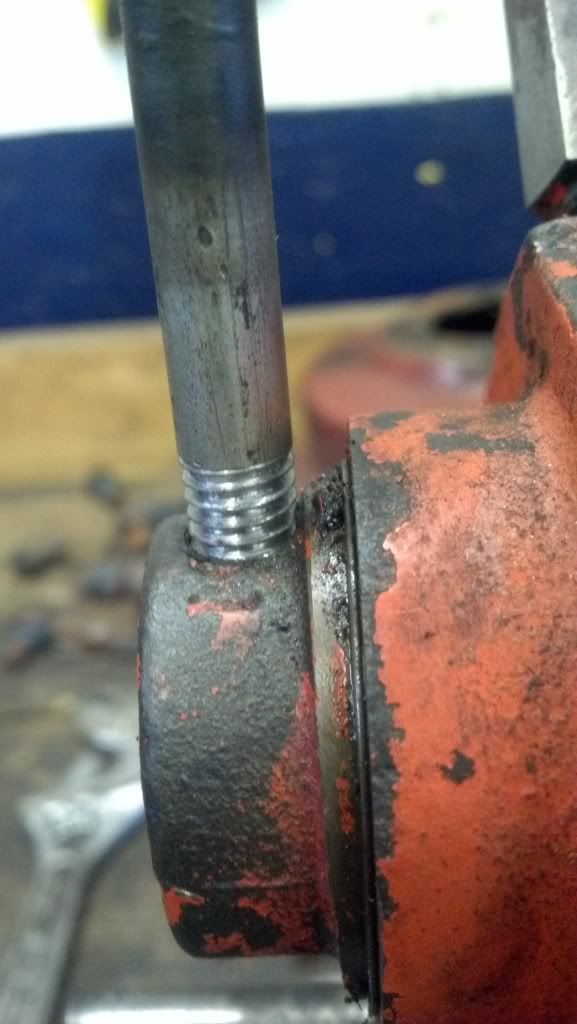

The '65 had a hydraulic lift on it; I took the lift off, and I want to put it onto the '71. The linkages had all kinds of wear and play in them so I was going to remake them. Instead of remaking all of the pieces, I decided to go with a simple lever off of the hydro unit. Today I made a lever, the problem is that the threads keep stripping off of the rod. It is only mild steel. It is 3/8 rod with NC16 threads on it. If I tempered it do you think it would solve this problem? Is that a difficult process?

Mild steel isn't going to temper very well. Are you sure your die is sharp? How about alternatives like a 3/8-16 headless bolt with 3/8 tubing brazed on.

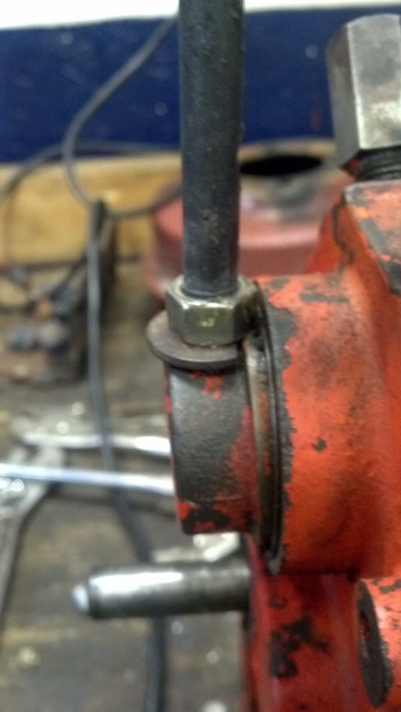

Well, I hope the piece I am looking at is right. Where the pipe goes into the pump? if so you may want to cut a few threads deeper, Then 'temper it' by getting it red hot then cold water bath. Once that is done you can seal with 'red' locktite and use a lock nut on the new threads. My logic is the 'tempering' will make it 'harder' then the loctite will lock the assembly together and the lock nut will not permit any vibrtion. so you should 'theoretically' wind up with a tight perfect seal that is oblivious to vibration and leak...
Exactly this was my first plan. But there is a ridge that would make it difficult and I don't know if the nut would clear. I might be able to cut the side off of a washer to compensate for that ridge.

Are the threads you are putting the rod in worn out?
and that is a very real possibility. Never gave it a thought. Better check that out too.

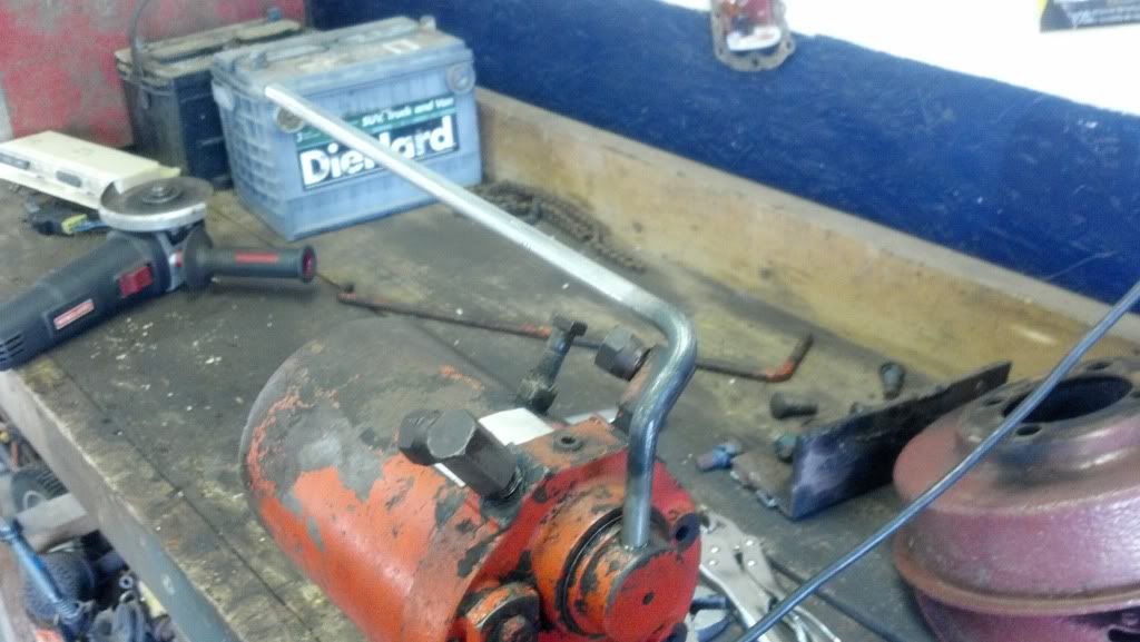

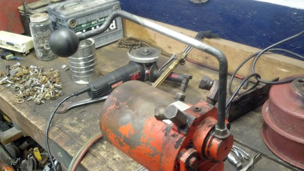

At first I case hardened the rod and used a cut washer and a locking nut. It still stripped out. Like said, the threads were worn from being stripped and tapped a few times.
s
So, I bent over the other side and tapped then case hardened that. This method works like a charm! It's to bad that the steering column is in the way, because the bends in the rod now are otherwise perfect! Lol!
I am going to have to get another rod to make the lever again.
